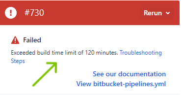

Hi!
I have an issue when I try to run the tests with firefox browser in Bitbucket Pipeline, the tests never finish and after 2 hours shows the error -> "Exceeded build time limit of 120 minutes", I don´t know why is happening that, because I´ve tried with Edge and Chrome browsers and they´re okay.
This issue has been happening for 5 days so I think it´s the last version of Firefox, because the previous time it was working. Also, I´ve tried with old versions but I´ve got the same problem.
Please, can you help me with that?
Thanks in advance.

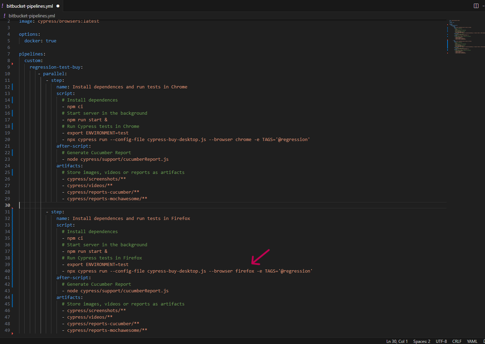

Hi @Patrik S !
Thanks for your answer, so I´m using bitbucket-pipelines.yml file, I attached a screenshot about my steps in that file. I´m working with Cypress, Cucumber, Gherkin and Javascript to automate the tests.

Hello @Kimberling Yarihuaman ,
Thanks for sharing the screenshot.
I'm not really familiar with cypress, but one thing I can think of is your step running close to the memory limit, and somehow causing the tests to get stuck hence resulting in the build to timeout.
For that, I would suggest trying increasing the step size to 2x, so it will get 8GB of memory (compared to 4GB by default):
- step:
name: Install dependencies and run tests in Firefox
script:
- <your script commands>
If that doesn't work, you may want to try troubleshooting the pipeline locally to see if the same error happens and isolate if it only happens on the pipelines environment, or in your local environment as well:

kimberling yarihuaman
September 16, 2024
Hi @Patrik S !
My pipeline is working well with the memory increase.
Thanks so much!
