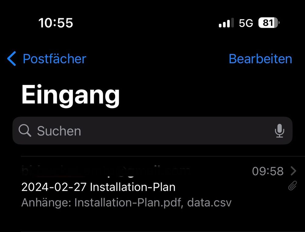

pascal_schroeer
February 27, 2024
In my in inbox I see this:
So two attachments are mentioned, but only the file „data.csv“ is attached.

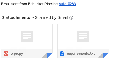

Igor Stoyanov
March 1, 2024
@pascal_schroeer hi. I used this pipe by myself and see the two files.Screenshot 2024-03-01 at 17.41.41.png
Regards, Igor
