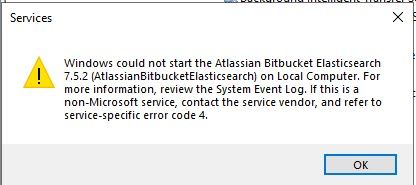

I upgraded to Bitbucket Server 7.0 yesterday. Atlassian Bitbucket service starts, but Atlassian Bitbucket Elasticsearch service does not. I am receiving the following error:
Windows Event Viewer:
The Atlassian Bitbucket Elasticsearch 7.5.2 (AtlassianBitbucketElasticsearch) service terminated with the following service-specific error:
The system cannot open the file.
System Info:
  • Microsoft Windows Server 2019, 64-bit
  • MS SQL Server 2017
  • Java JDK 11
I've checked the following:
  • JAVA_HOME & JRE_HOME environment variables:  It's been unclear what JRE_HOME should be when using JDK 11 (since Java no longer bundles the JRE separately). I've tried setting JRE_HOME to be equal to JAVA_HOME, as well as setting it to [JAVA_HOME]\bin.
  • Services: I used Bitbucket & Bitbucket ElasticSearch Configuration Managers to update the paths on the Java tabs of the services.
  • IP address: I checked the bitbucket.properties file for any references to IP address. There were none.

I tried uninstalling & reinstalling the Bitbucket Elasticsearch service. Instead of the error mentioned above, I'm now getting the following error:
The Atlassian Bitbucket Elasticsearch service terminated unexpectedly.
Reinstalling was very difficult because the elasticsearch-service.bat file referenced a directory that had a slightly different name (config-template instead of config). I had to make a copy & rename. Once I was able to run the bat file, the service it created had the wrong name. I had to modified the script, & then further customize the service once it was created.
