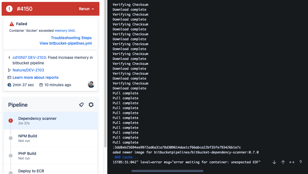

I'm using the Bitbucket dependency scanner to check for vulnerabilities, but I frequently encounter a Docker memory limit error. I've tried increasing the memory using size: 2x and size: 4x, both within the pipe and at the step level, but the issue persists. Strangely, the pipeline does succeed occasionally.
I also tried with suppressions file and without suppressions file but got same error.
The error message I receive is:
msg="error waiting for container: unexpected EOF"
It appears to be related to Docker exceeding the memory limit.
Any suggestions or help would be greatly appreciated.
