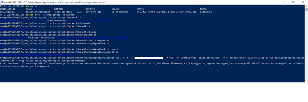

Issue:
Using the below command as per the documentation to import or migrate a repository to bitbucket: [Data Center and Server 7.12 version]
https://confluence.atlassian.com/bitbucketserver/importing-957497836.html
curl -s -n -u "XXXX:XXXXX" -X POST -H 'Content-type: application/json' -d '{"archivePath":"2021-04-25_15-20-656_mydevopsproject1_nodejs_export.tar"}' http://localhost:7990/rest/api/1.0/migration/import
Checks:
  • The username and Password used is correct and has admin privilege
  • Commands are run with elevated or admin access
Steps Followed:
  • Created a local setup for the data center as per the below documentation https://hub.docker.com/r/atlassian/bitbucket-server
  • Copied over the repository to the import folder using the docker cp source_path container:destination_path
  • Tried running the curl command mentioned in the document to begin the import process but it fails with the "null for URI" 404 error. The only difference noticed is that the URL used is modified because the latter path "imports" structure was non-existent.
http://localhost:7990/rest/api/1.0/migration/imports

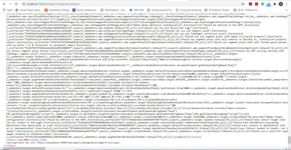

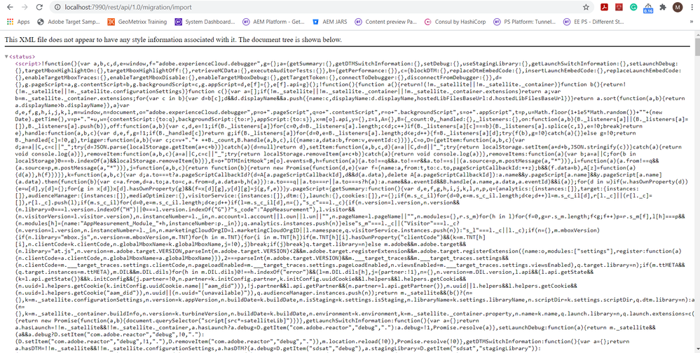

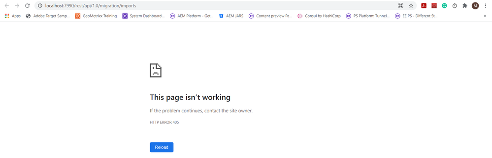

Manoj.S.J
April 26, 2021
Hi @Christian Glockner ,
The URL is not accessible and seems like a non-existing path. I believe this is because the docker container does not have a "imports" folder. But can confirm that latest docker image was pulled during the execution. PFB the response when accessed via client browser for both scenarios.

Christian Glockner
April 26, 2021
Hi,
The correct URL is /imports - the error you're getting in the browser (and HTTP 405 error) means that the URL does not support the GET method (which a browser uses to retrieve the URL). This does not mean that the URL doesn't work or is invalid.

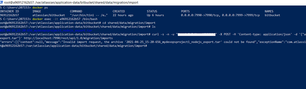

Manoj.S.J
April 26, 2021
Hi @Christian Glockner,
Got it, checked the API definition, and have updated it accordingly. However, getting the below error even if the archive is present in the shared/data/migration/import.
Could you please let me know if there are any issues in the followed steps:
  • Tried running the below command in the same path
  • curl -s -n -u "usr:pwd" -X POST -H 'Content-type: application/json' -d '{"archivePath":"2021-04-25_15-20-656_mydevopsproject1_nodejs_export.tar"}' http://localhost:7990/rest/api/1.0/migration/imports
Thanks,
Manoj
