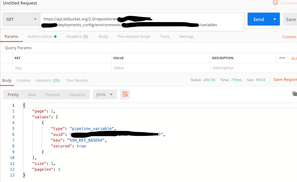

March 10, 2020
there must be something related to your curl that's causing the problem. I've tried the API with my postman setup and got back a 200 for my repository. It all looks ok to me on the surface though. Maybe some kind of escaping issue in bash?Screen Shot 2020-03-11 at 3.13.28 pm.png
Rupert Broad
March 11, 2020
@mkleintthanks for looking at this - apparently it's the curly brackets that are causing the issue. That and the poor API documentation ;)
