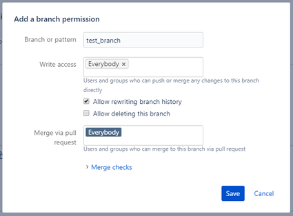

Our team uses BitBucket as our main version control service (the excellent service, btw!). We faced a little problem trying to set up the correct branch permissions in our project. What I want to do is set up the permissions for 'develop' branch so that the 'Senior Developers' group has the write access WITH the 'Rewriting branch history' access setting and the 'Middle Developers' group has the write access WITHOUT the 'Rewriting branch history' access setting.
I have to set up the two rules since they are slightly different. But the problem is that when I'm trying to apply the second rule the first one is gone (becomes re-written), and vice versa. It seems we are not allowed to set two rules for the same branch. How can I apply these rules with such a restriction?

Thank you very much for the detailed answer. But there is a one big "Whoops" -- it seems I described the situation poorly. I meant not the Bitbucket Server, but the Bitbucket Cloud. In branch permission window there, we have the similar structure of settings, BUT we don't have the fields in "Allow rewriting branch history" and "Allow deleting this branch" settings (only checkboxes) where we can specify the exact users/groups which are allowed to do these things (and where I can configure "except by" users/groups which you demonstrated).

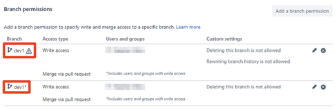

You are correct in that Bitbucket cloud will only allow a single named branch level permissions (of the same name), if you attempted to create a new branch level permissions with the same name it would overwrite the old.
However, a workaround to this would be to create branch permissions with a wildcard in the name. Something to be aware of is that this may create an overlapping permission scheme. Here is a screenshot of what this type of branch permission would look like:
Here is the supporting documentation for this Branch permissions | Branch permissions overlap.
I hope this information proves helpful in allowing you to control your branch level permissions with flexibility.

Thank you very much for your detailed answer again. Yes, this workaround seems to be working in our case.
The problem is solved, thanks! :)
