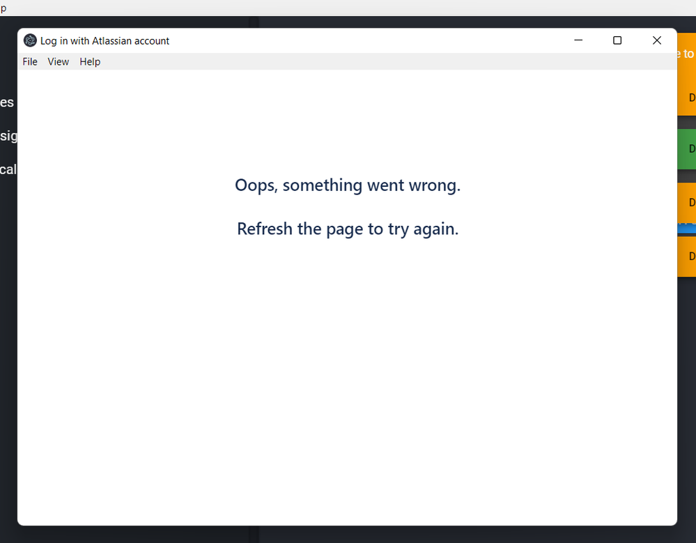

My windows app was built on electron and was using the same method (which was working flawlessly before Feb'23). We noticed that it stopped working suddenly. It started showing this page in In app browser.

there is a redirect happens for authorization when you try to open
https://bitbucket.org/site/oauth2/authorize?client_id={client_id}&response_type=token it redirects to id.atlassian.com. Something like below
Now this redirection was working before and the loading of login page was working before, but it stopped suddenly in Feb'23.
My question is that, is this not supported anymore into in-app browsers? Has there any change happened on id.atlassian.com?
