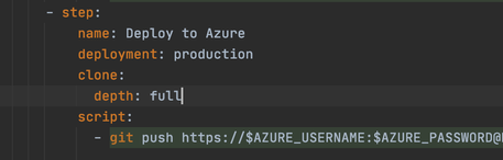

I found that Bitbucket by default uses shallowed version of your git repository (probably because of performance). So there are different options, you can change your Azure (Kudu) settings to accept shallowed version or you can tell bitbucket to use full repository clone, for example:
the clone property didn't work for me, still the same problem, and cannot tell Kudu to accept shallow copy when using .deployment script
Yeah, it would be pretty hard then to understand where's the problem.
