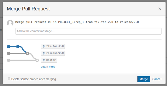

If you want to see a full cascade based on your setup, try this:
git checkout release/2.0
touch a.txt
git add a.txt
git commit -m 'to see cascade'
git push origin HEAD:refs/heads/fix-for-2.0
And then create a pull-request to merge this new "fix-for-2.0" branch into "release/2.0".   Right away on the pull-request merge dialog you'll see that it wants to do the cascade:

So in short, direct pull request of a release branch into develop does not cascade, but pull request of a feature branch into release branch does cause the cascade. This is definitely some valuable information.
I got my branches to work correctly now.
Thank you for such a clear explanation!
