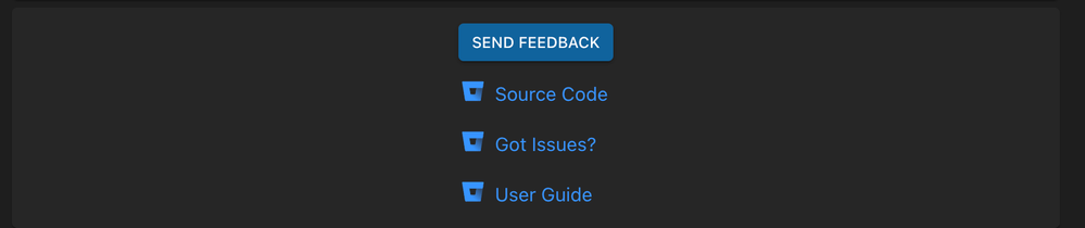

Since the above is a workaround, if you would prefer to have a way to set the default transition and branches you can suggest this as an improvement for the VSCode extension by navigating to the Extension settings and clicking on Send Feedback button:
Thank you, @Boudjelal Yannick !
