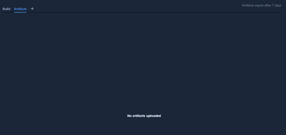

First Question : Whether it is possible to create the artifact for the default branch or not ? When master branch having different step. Please have a look in below bitbucket-pipeline.yaml
Second Question :
Trying to achieve:
- Trying to create the artifact for the default branch ? Not sure whether possible or not.
Issue facing:
Created the artifacts section but it is showing "no artifacts available"
Tried Out following things:
I have tried different patterns to get artifacts.
Please replace thees patterns in artifacts:
Pattern 1: $BITBUCKET_BUILD_NUMBER.war
Pattern 2: $BITBUCKET_BRANCH/*.war
Pattern 3: $BITBUCKET_BRANCH/$BITBUCKET_BUILD_NUMBER.war
Could anyone please help me out to resolve the issue. Or please let me know where I am doing wrong.

Did I get it right that you're trying to build artifacts for master branch? If so, they're not created with your current build config because you have an explicit configuration for branch master which doesn't define any artifacts. As in, default pipeline is not being triggered for changes in master branch (as well as changes in development branch since it has an explicit pipeline too).
As for the artifact name, Pattern 1 would work at the moment since you're moving your war into $BITBUCKET_BUILD_NUMBER.war in the last command of your script. But again, it would work only on a branch which is not called master or development.

Daniil Penkin
December 9, 2019
Hm, the artifact definition might be not resolving env variables — I'm not sure about this and can't find immediate proof.
Try changing it to use wildcard for all *.war files, like this:
artifacts:
- build/libs/*.war
If that works, my assumption was correct.
MarbleCart December 9, 2019
@Daniil Penkin ,
Actually it works. Still not able to figure out why it is not able to get the env variable
