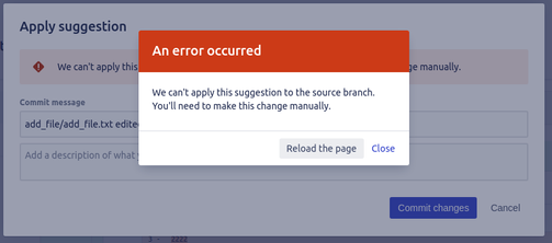

Developers have started complaining that the newly introduced suggestions feature doesn't work anymore, and everyone gets the following error when trying to use the suggestion.
"We can't apply this suggestion to the source branch. You'll need to make this change manually."
(which is less than helpful, it's a very wordy "something went wrong")

I'm one of maintainer of mentioned plugin (YACC), which uses repository / global hooks to control the contents of commit message and reject changes if message is not valid.
In version 1.25 we have added checking of changes made from Bitbucket UI and I found that:
  1. Bitbucket 7.4.0 Apply suggestion feature produces FILE_EDIT hook event, which fires hook and displays error when hook vetoes this change, but it doesn't display reject details, which doesn't allow developer to understand the reasons of reject:
    If you edit file from source viewer, details message is displayed properly:
    This doesn't seem convenient, so it would be great to see similar message when you try to apply suggestion from pull request comments.
  2. Moreover, if applying suggestion is rejected once, it is cached then and it's not possible to repeat an attempt applying it. Again, committing change from source editor allows to edit and commit change if it was rejected before - would be nice to have a consistence here too.
Thanks.
