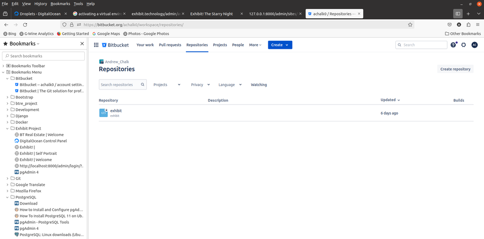

Andrew Chalk
March 16, 2024
That worked, but i am baffled why that URL is correct. Here is a screenshot of Bitbucket showing the workspace name as "Andrew_Chalk", yet the URL with that does not work:
Thanks.
Syahrul
March 17, 2024
Hey @Andrew Chalk
There might be a mix-up between your workspace name and workspace ID, two distinct entities.
Your workspace name is "andrew_chalk", whereas your workspace ID is "achalk0". For git operations, we utilize the workspace ID, not the workspace name. Therefore, your URL appears invalid because it contains the workspace name "andrew_chalk" instead of the correct workspace ID, "achalk0".
To view your workspace name and ID, you can head to your workspace settings. Both should be listed there.
Regards,
Syahrul
Andrew Chalk
March 17, 2024
Exactly the problem!
I appreciate your help on this.
