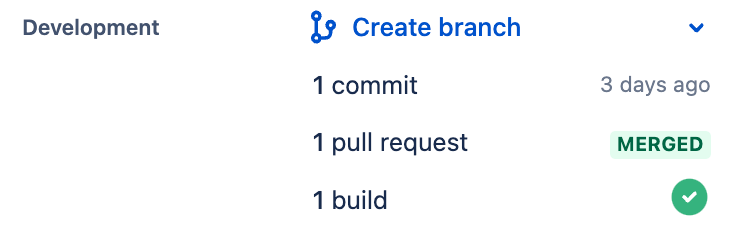

We have the following field (?) in the Jira Screen that already shows that there is a pull request but it would also be needed in the comment.

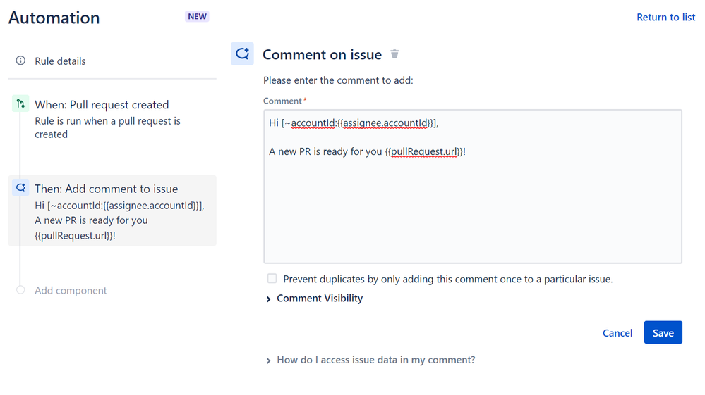

Hi @Vanessa
You can create a simple automation, for example (first part is optional):
Hi [~accountId:{{assignee.accountId}}],
A new PR is ready for you {{pullRequest.url}}!
You can read more about development smart values here: https://support.atlassian.com/cloud-automation/docs/jira-smart-values-development/

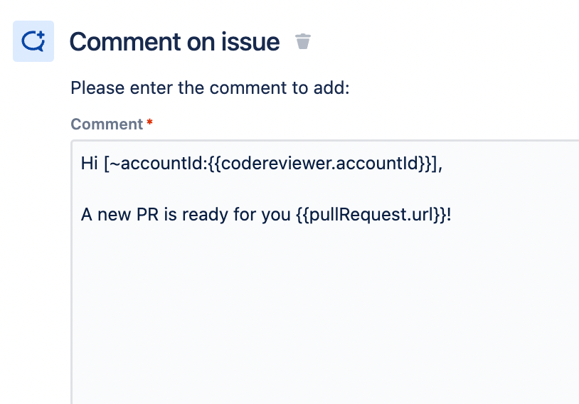

In the Automation I wrote it like this:

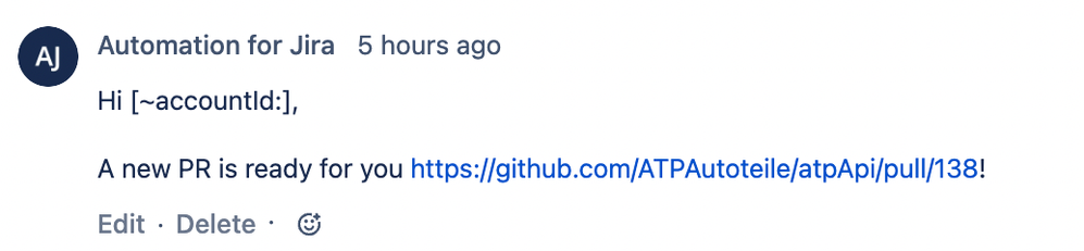

Do I need to name it Code Reviewer.accountID ?
Or why would it not put the Code Reviewer in the comment? (The field is filled out, I just used an empty example picture here)

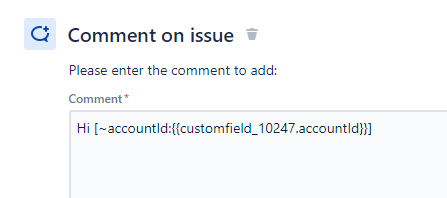

As Stefan mentioned, the "Code reviewer" feature does not exist natively in Jira. So I assumed the next best thing is assignee.
Since you created a custom field, yes, you can use it instead of "assignee". I don't think you can use "Code Reviewer.accountID", but you can get the id for the custom field: "Hi [~accountId:{{customfield_XXXX.accountId}}]", where XXXXX is the custom field id.
You can find the id by following this guide https://confluence.atlassian.com/jirakb/how-to-find-id-for-custom-field-s-744522503.html
