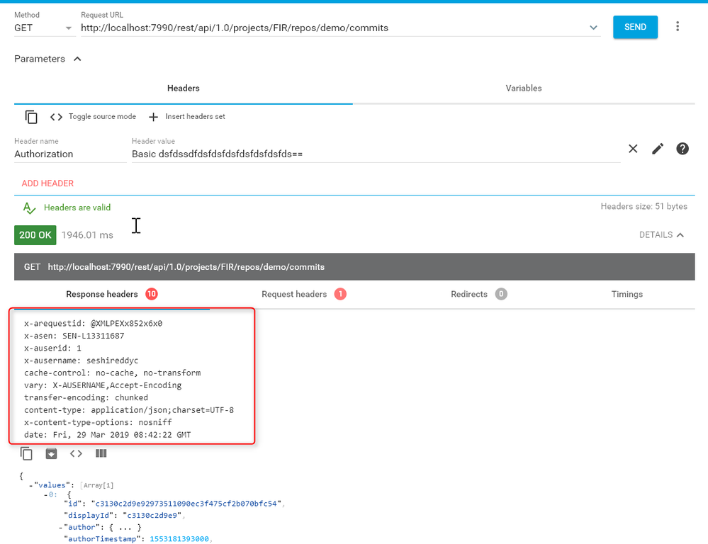

We are trying to Access the Bitbucket Rest services directly via web browser(Browser is making call to bit bucket service  directly no back end service interaction)
We are getting below exception :
XMLHttpRequest at 'http://hostA:7990/rest/api/1.0/projects/FIR/repos/demo/commits'
from origin 'https://hostA:8080'
has been blocked by CORS policy: Response to preflight request doesn't pass access control check:
No 'Access-Control-Allow-Origin' header is present on the requested resource.
also above information and this information https://jira.atlassian.com/browse/BSERV-10589
is contradicting
Also CORS header is not present in response, please .

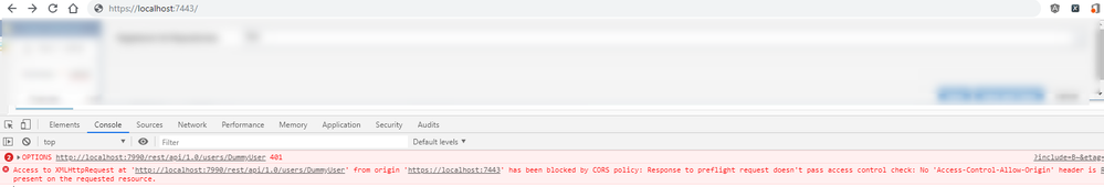

i am trying something like below.
I have a web application(Demp App) which is running on port 7443 and it has some UI and from UI we are making call as shown below
i.e, it will not hit the Demo App, but it tries to connect bibucket server and it gives CORS
xhr.get("http://localhost:7990/rest/api/1.0/users/UserId, {
headers: {
"X-Atlassian-Token": "no-check",
"Access-Control-Allow-Origins" : "*",
"Access-Control-Allow-Methods":"OPTIONS",
"Authorization": "Bearer "+accessToken
Please refer below screenshot
Thanks in Advance.
