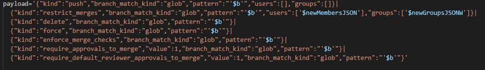

I've worked in a shell script to run a job into Rundeck platform, and when it pass by the payload to set the branch restrictions via cUrl -X POST, the rules are not created when i set the groups that are immune to this, but when i dont set them, the rules work's well

Hi @Patrik S , thanks for answering me, i've been successful in creating the branch-restrictions, with this payload: image.png
