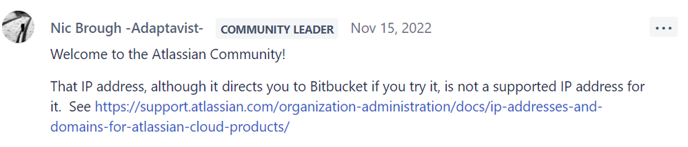

On another post, I found that there is some one mentioning this IP is not supported.  Is this still the case? As it looks like it should be covered by 104.192.136.0/21
Post: https://community.atlassian.com/t5/Bitbucket-questions/IP-Blacklisted-104-192-141-1/qaq-p/2191936

Hey @Jging Fai Chong ,
The IP 104.192.141.1 is still supported and, as you mentioned, is covered in the range 104.192.136.0/21 provided in our official Bitbucket Cloud IP's documentation
