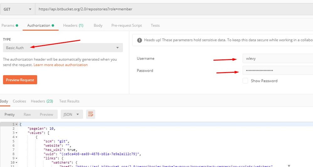

Reading back what you've written, I think the issue may be that you are using the browser, which isn't allowing you to authenticate. I would recommend that you try doing this via Postman (either online or download the free app) to know that your authentication is working. You can see from the screenshot below that I'm using Basic Auth and my username and API token to successfully get data returned.
Once you get to this point using Postman and know that it is working, you can then try some other route.
