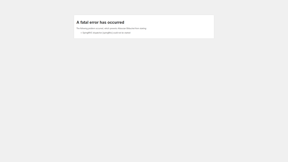

A fatal error has occurred: SpringMVC dispatcher [springMvc] could not be started
Matti Kiviharju
November 26, 2022
I get error above after I upgraded my Bitbucket Server to latest.
Error massages is below:

Matti Kiviharju
November 26, 2022
I found an answer and it is install Git version 2.37.3 and not 2.35.0 or something else: https://askubuntu.com/questions/1442582/how-to-downgrade-git-from-version-2-38-1-to-2-37-3-on-ubuntu-20-04
And now it works perfect: https://bitbucket.i4ware.fi/
Matti Kiviharju
November 26, 2022
I tried to upgrader Git and now I get this error: You are using Git 2.38.1. This version is not supported due to changes which break core Bitbucket functionality. Downgrade to a supported version and restart, or check for later versions of Bitbucket that support Git 2.38.1.
