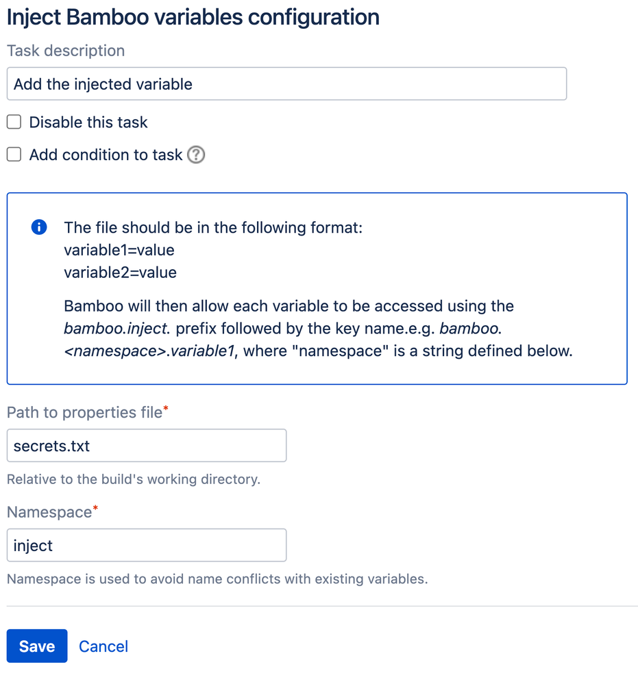

I then have an "Inject Bamboo Variables" task (see image), but I don't have a "scope" field.
So the question I have is, will this still work, and if so, I'm having a hard time accessing the AVI_PASSWORD variable in other "Forge Manifest Processor" Tasks - I have been trying to access the variable like this:
$bamboo_inject_AVI_PASSWORD
I should be good to go once I have this corrected.  Once again, Thank you so much for your help.

Eduardo Alvarenga
December 19, 2022
Hello @David Desjardins
Thank you for the extra details.
"Scope of the variables" was introduced in Bamboo 7.0. As you don't have that option I assume you are using an earlier version of Bamboo -- I highly recommend you plan an upgrade as soon as possible.
The steps you have provided so far are accurate. If all your tasks are contained on the same Bamboo Job, the bamboo_inject_AVI_PASSWORD variable will be passed over to the next tasks within the same Job. But, if you want to use that variable within different stages, you need to have the variable set at the "Result" scope level, only present on Bamboo 7.0+.
