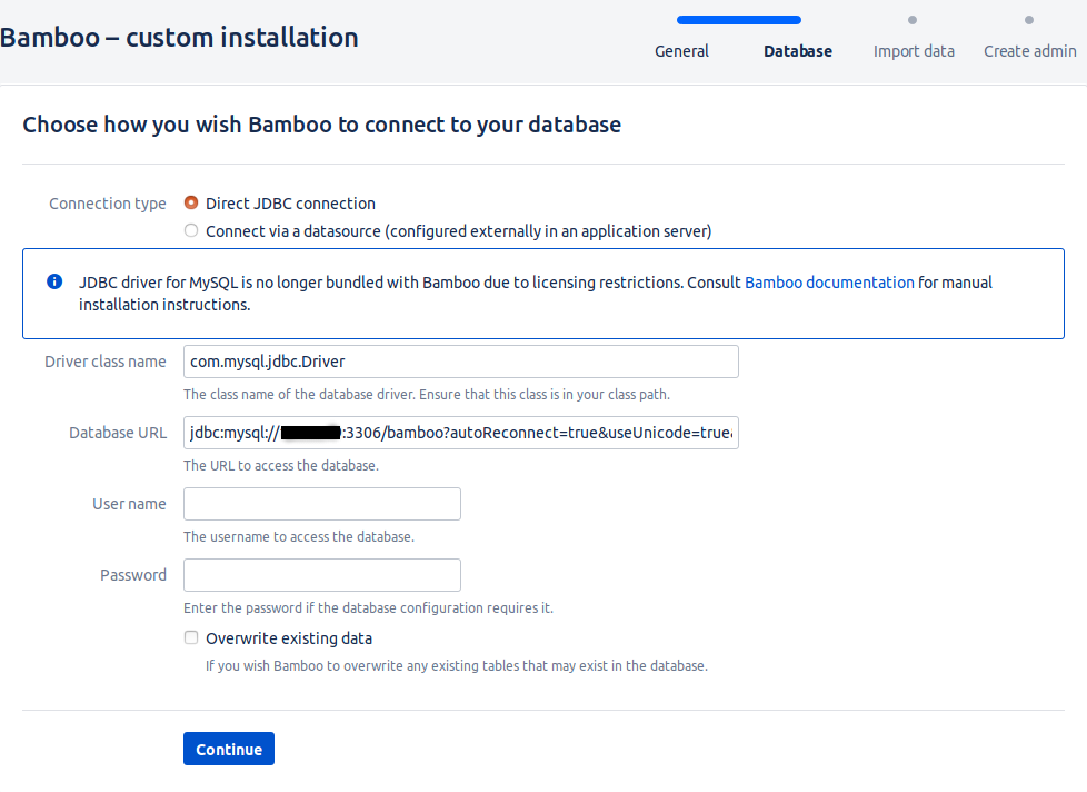

Hello,
impossible to connect my bamboo server to mysql server.
The mysql server is on another server. The ping and the mysql client connection from the bamboo server is working properly. The driver of mysql is installed and added to the lib dir pof bamboo through a symbolic link.Screenshot_2019-03-05 Choose how you wish Bamboo to connect to your database - Atlassian Bamboo.png

3 answers
Alexis Robert
March 5, 2019
Hi @[deleted] ,
can you find an error in the logs that might give more details on why you're getting an issue conecting to MySQL ?
Thanks,
--Alexis
Deleted user
March 5, 2019
Thanks, I have added the logs from catalina.out
Akhtaruzzaman SM
July 12, 2020
Thanks. No clear idea to me. AKTAR
V V S N Sudheer Vissa
November 18, 2022
Please Update Database Driver which is compatible with current DB version. Test Drivers until supports current DB version.
and useSSL=true /  useSSL=false should be added to DB host URL.
Foong
March 6, 2019
According to this KB, it is a bug in MySQL.
Try removing "&characterEncoding=utf8" from the Database URL.

March 6, 2019
Thanks, but it change nothing, I added this because it failes at first,  but even after retring it, still continue to fail.
So I only kept "?autoReconnect=true"
the mysql driver version is 5.1.25
Foong
March 6, 2019
The latest stack trace still showing the same error?
Caused by: java.lang.NullPointerException
at com.mysql.jdbc.ConnectionImpl.getServerCharacterEncoding(ConnectionImpl.java:3281)
 What is the MySQL server version?
Deleted user
March 6, 2019
yes, still the same error
Mysql version is 8.0.15
Deleted user
March 6, 2019
I try to upgrade to mysql connector version to the last one ... and miracle it's working!
thanks for the help
Like # people like this
Foong
March 6, 2019
Take note that MySQL server version 8 is not supported yet.
Feature request to support MySQL server version 8 https://jira.atlassian.com/browse/BAM-19869
Deleted user
March 6, 2019
Well, the issue doesn't help. IS there anything broken? Why the interface didn't say anything?
Foong
March 6, 2019
Bamboo does not limit the usage of MySQL server 8 yet and there isn't any known issue with using MySQL 8.
MySQL 8 isn't stated as supported cause it is not tested to be working fine with Bamboo yet.
