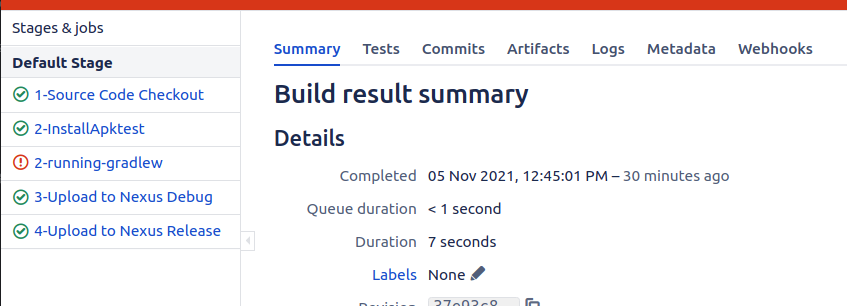

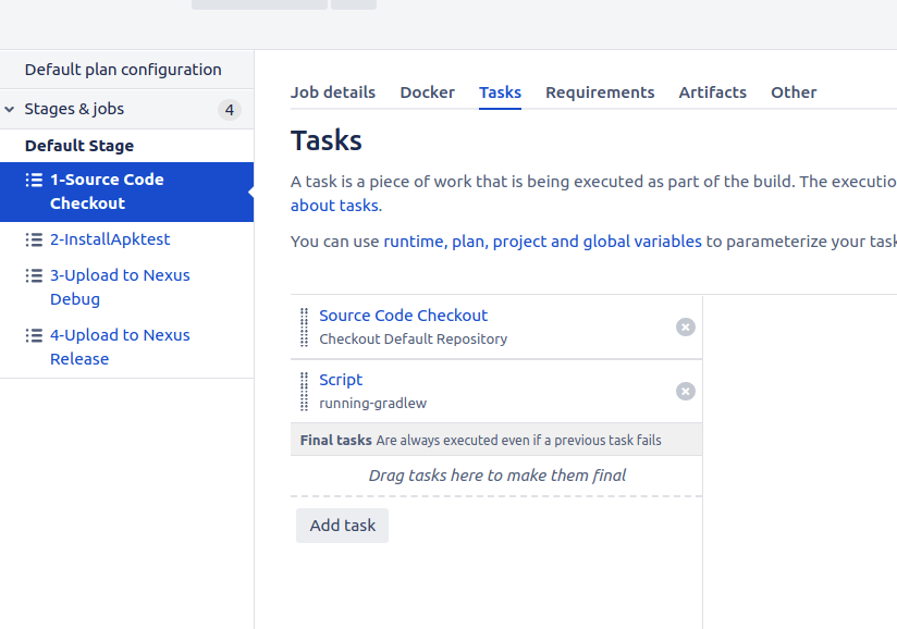

×Basically I have 4 or 5 tasks, which need to connect to the repository, build, test on virtual android and upload to Nexus Oss, I need to leave it in a way that if one task gives an error, the others shouldn't start. In the documentation it says: "The build tasks will run sequentially in the order specified in the job. If a build task fails, all subsequent tests will not run." But that didn't happen, everything turned green, even one of the first ones went wrong. Thank you, I await a return...

As per your screenshot, you are running multiple Jobs within the same Stage in Bamboo. Jobs will run in parallel and will not consider the results of their sibling jobs.
To instruct a Plan to stop upon a failed Job, you need to assign each Job to distinct Stages.
Stages group (or map) jobs to individual steps within a plan's build process. For example, you may have an overall build process plan that comprises a compilation step, followed by several test steps, followed by a deployment step. You can create separate Bamboo stages to represent each of these steps.
Whenever one of the Stages fail, the next upcoming Stage will not be triggered.
