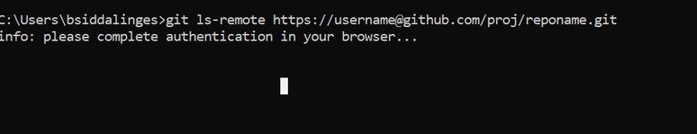

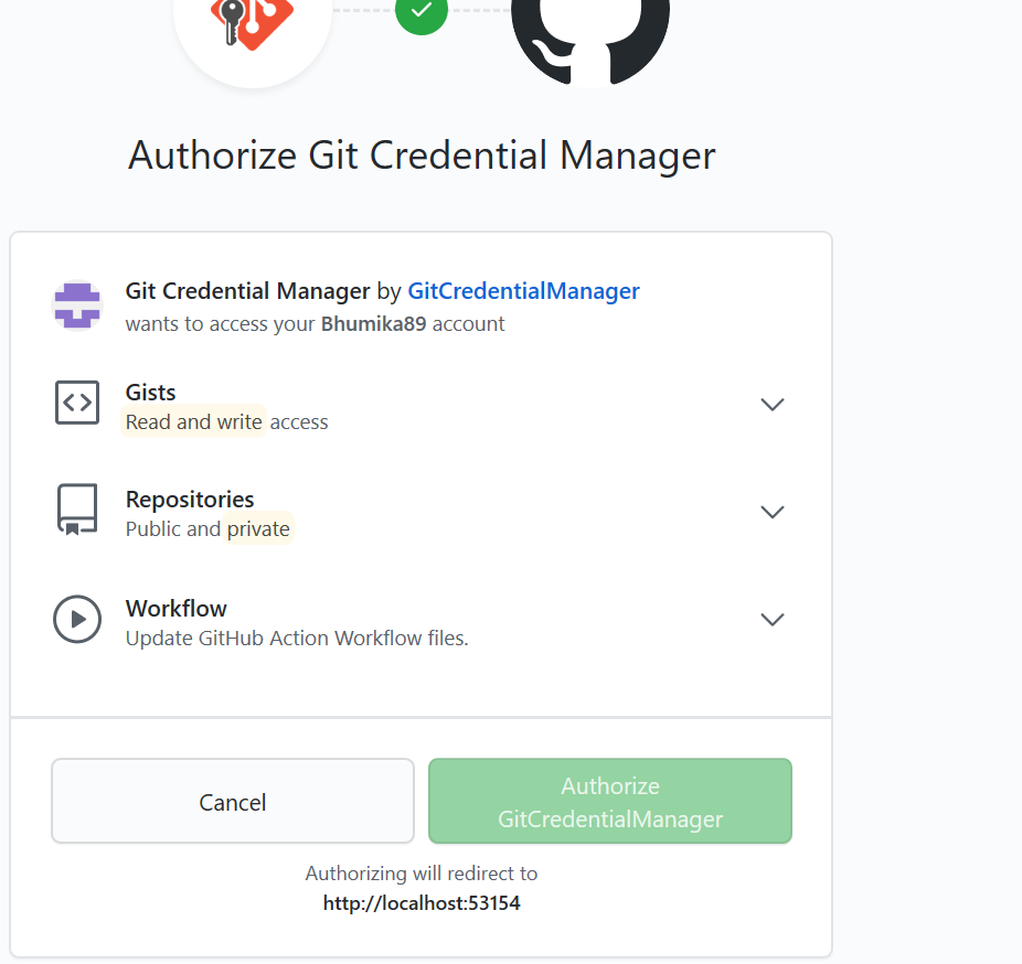

Hello !
I have tried that cmd in cmd promt as I typed it went to crome for checking username and pwd   U can see I have shared images also but after that not able to choose in any of the 3 option U can see it

bhumika kaddugol
December 19, 2020
bhumika kaddugol
December 19, 2020
Hello !
Jeyanthan I
December 19, 2020
Hi Bhumika,
From your screenshot, I see you have copy-pasted my command literally without modifying it with your username and the respective Git repository. Please contact your administrator for any assistance with running the respective command via command prompt.
Cheers,
Jey
