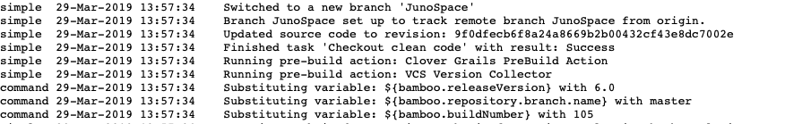

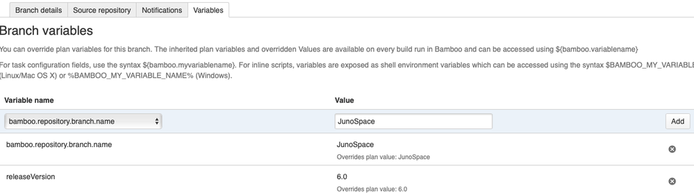

I am unable to get correct branch in my new branch as bamboo is not honoring the new branch instead it is substituting new branch 'ABC' for 'Master' everytime I do a build in ABC branch it substitutes the ABC branch for Master branch. I have checked the variables in ABC branch are set correctly.

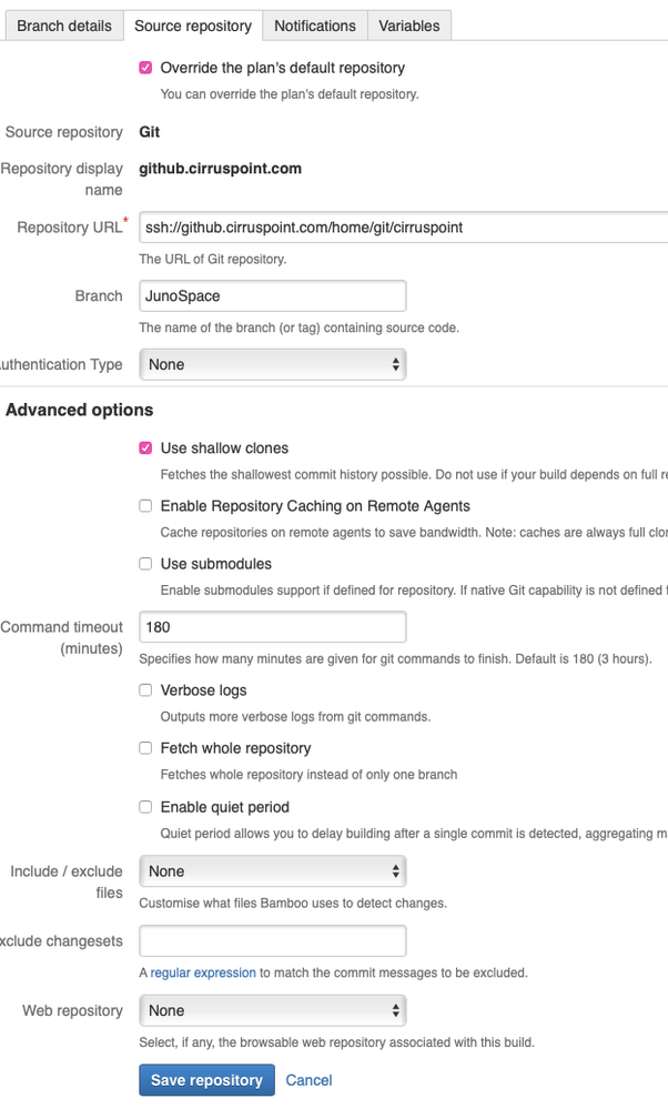

Bamboo should honor that the first repository of your plan matches the source branch that caused the plan branch creation. That is not the case for any other extra repositories added to the same plan. All others will be automatically set to the default branch in the repository configuration which is usually master.
It is important to notice that, for plan branches, in newer versions of Bamboo you are able to set any source branch available in your source repository. This configuration can be found at Plan configuration >> (Affected Branch) >> Repositories >> (First repository) >> Branch field.

Still not working see screenshots it keeps substituting Junospace with Master branch

Thank you for attaching the screenshots, they are really helpful to diagnose the issue.
Now I think I got what is happening there.
First of all, the variable echo bamboo.repository.branch.name is read-only. It is a variable that is now deprecated, still sitting there only for compatibility purposes.
I'm not sure what is the Bamboo version you use there, but the most recent Bamboo versions have this variable bamboo.planRepository.<position>.branch. (Bamboo variables).
Please give it a try and you should see the correct branch according to what is configured in your plan branch source repository.
