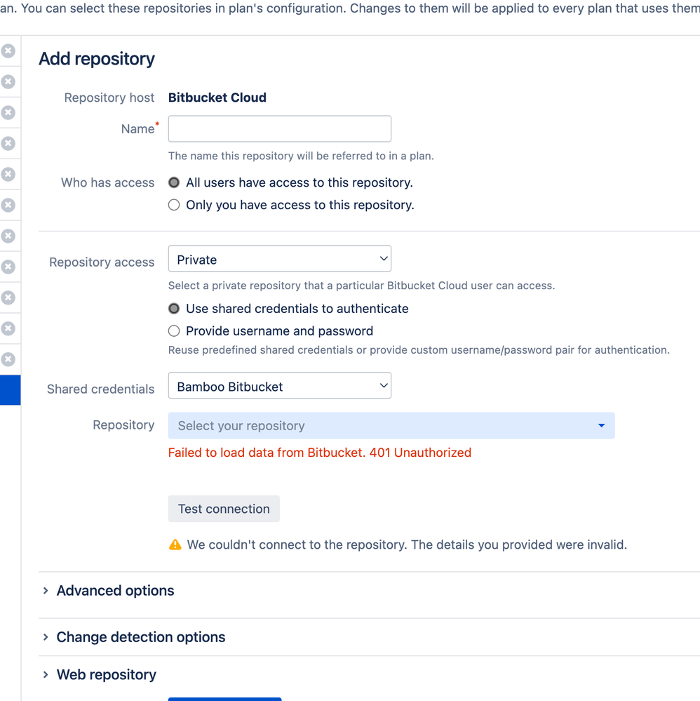

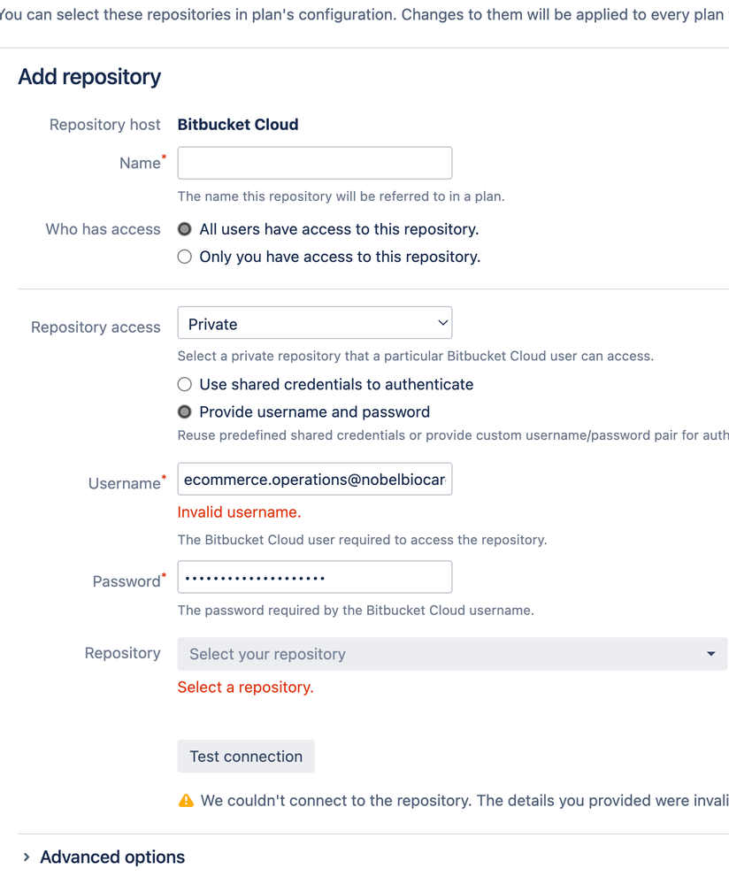

I have serious issues with this basic integration, which should be probably the simplest one and should work by default.
So I am trying to integrated Bamboo 8.0.4 with Bitbucket cloud.
Adding a Linked Repository with shared credentials (SSH or username/password) combo do not work. Setting directly the username and password does not work either.

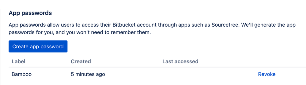

I create an "app password" in the bitbucket user account that I want to use with full permissions for repos.

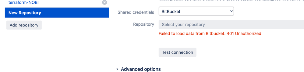

I add it to the Bamboo "shared credentials". It does not work to add a new BitBucket cloud repo.

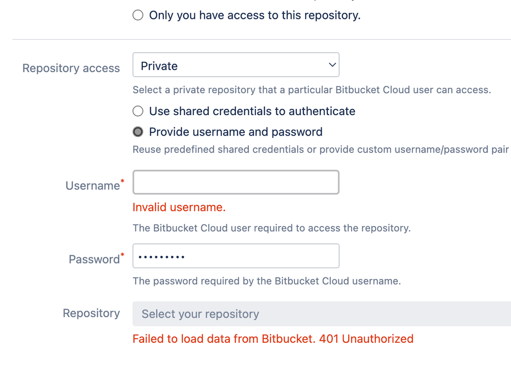

I try the username/newly created password directly - the same - it detects not the repos.

You are on the right way. You need to use your Bitbucket.org username and not your email address as the username.
The app password needs to have the following minimal permissions:
  • Repositories (read)
  • Account (read)
And optionally:
  • Pull requests
  • Webhooks
