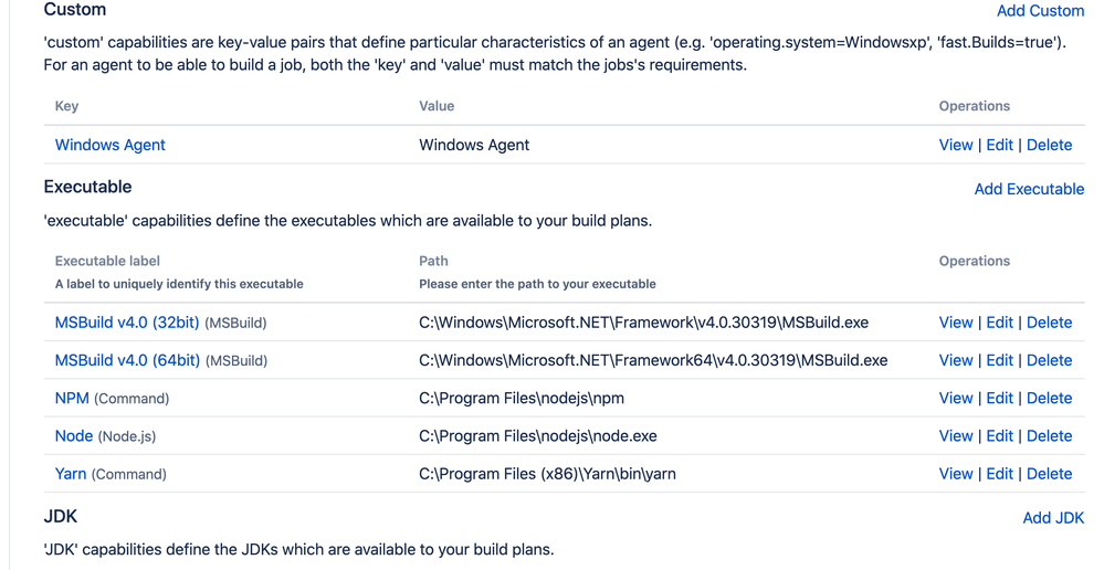

and echo path command from bamboo task return this
C:\Users\bamboo\bamboo-agent-home\xml-data\build-dir\MWC-CIWIN-JOB1>echo C:\Users\bamboo\AppData\Local\Microsoft\WindowsApps;
but while adding capabilities to agent, i added path to these tools. Picture attached.
Any suggestion is appreciated, thank you very much for the response and guiding in right direction.

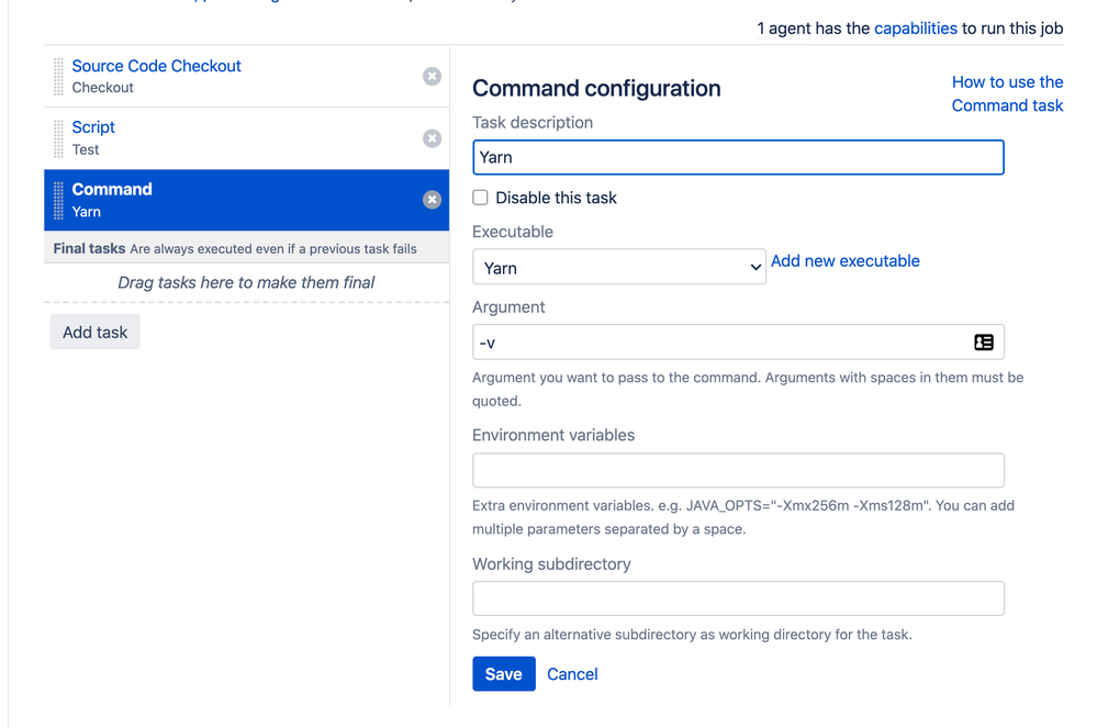

but as in the message above this message you see i added the capability(screenshot) and when i run this task(screenshot attached). I get the same error. How to get yarn then?
"Failing task since return code of [C:\Program Files (x86)\Yarn\bin\yarn -v] was -1 while expected 0"
Is it cause i am using command task ?? and these tasks might not work for windows cause script tasks returns fine and all the results.
