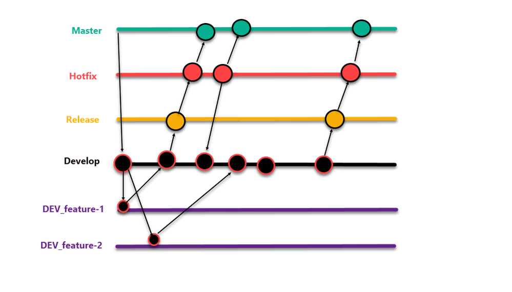

Edwin .Thank you so much for your reply.See the branching model attached.
I am planning to setup a build plan  for all the code that is being pushed to Develop branch. If the branch is checked out during the build , that means I am not allowing developers to push their changes from their DEV_Feature branch to Develop Branch. I do not want to stop the developers from pushing their code. Please advice ..Branch_Demo.png

I would look into plan branches, DEV_feature-1,2 branches should also have their own builds triggered by commits and merges. Then you can automate and auto merge the code into Develop after successful builds in the feature branches or merge manually.
Using plan branches
When you merge to Develop, it should trigger a build there as well .. then you can move to Release.
