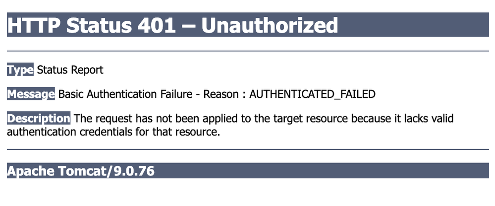

This was working fine until 2 days ago. Suddenly from yesterday, I'm getting a 401 Unauthorized error.
I'm getting this page when I try the same via Insomnia
The interesting thing is, I'm able to do all the actions from the UI and using curl with the same credentials. Any idea what I'm missing?

I think probably the authentication is not coming correctly via Insomnia. Just to double check can you try to access this API via Postman and check if you are getting the same error?

Thanks for the reply. I tried using postman too. Same response.

What errors do you see in <bamboo-home>logs>atlassian-bamboo.log file when you use the REST API from postman, does it print anything different from 401 error?

Hey, I think I got what the issue is.
Sometimes when I login, bamboo asks for a captcha verification. Whenever that happens, I'm getting the 401 error while using the REST API. Once I login to the UI after completing the captcha verification, the API requests are going through.
Is there a way to bypass captcha while accessing the REST API?
