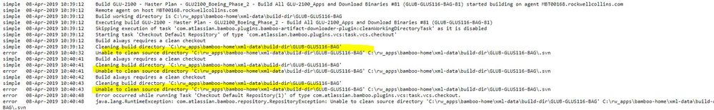

However, with "Force Clean Build" option, the first manual run worked perfectly but after that the "Source Code checkout" task fails every time. Following is the log :
Capture.JPGI also tried going to the path mentioned in the log on the remote server but C:\rw_apps\Bamboo-Home\xml-data\build-dir\GLUB-GLUS116-BAG this folder seems empty. Looks like Bamboo is not able to checkout the source code anymore. Since the task failed, even manual clean ups and SVN updates are not working.
Any suggestions?

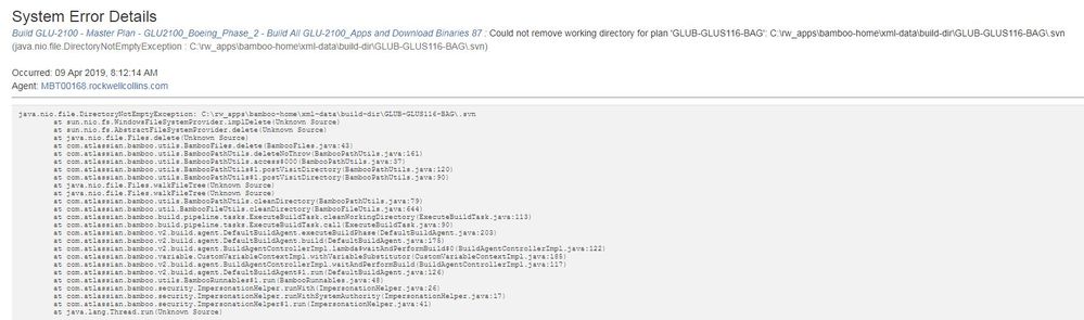

I tried setting up clean working directory fro miscellaneous tab but I received the following error. (Also I unchecked "Force Clean Build" since its only working the first time you try to create a build and then it makes all the other builds crash. Is it because of the "SVN cleanup" that is getting locked?)
Capture.JPGDoes this sound familiar?
