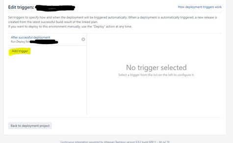

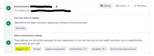

Yes you can do this, what you will need to do is on each environment you wish to deploy automatically.  Edit the environment, and select triggers:
Then you will want to click the add trigger button and select what type of trigger you would like to execute:
In the example above I'm using the successful completion of another deployment environment, but there are some other options as well.  This will automatically trigger the deployment of this environment when the trigger conditions are met.  You can use this to setup multiple environments the same way so they will all automatically trigger under the same conditions.
