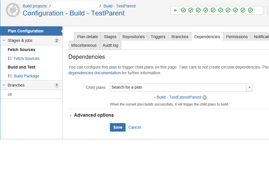

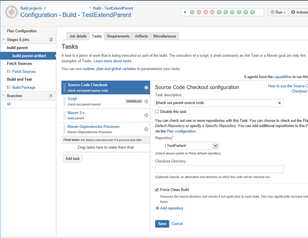

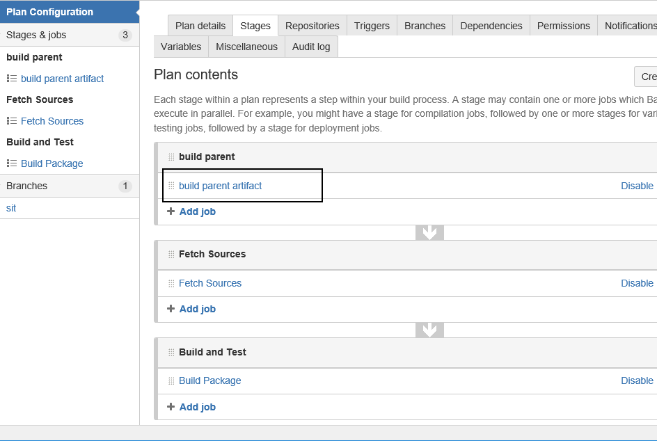

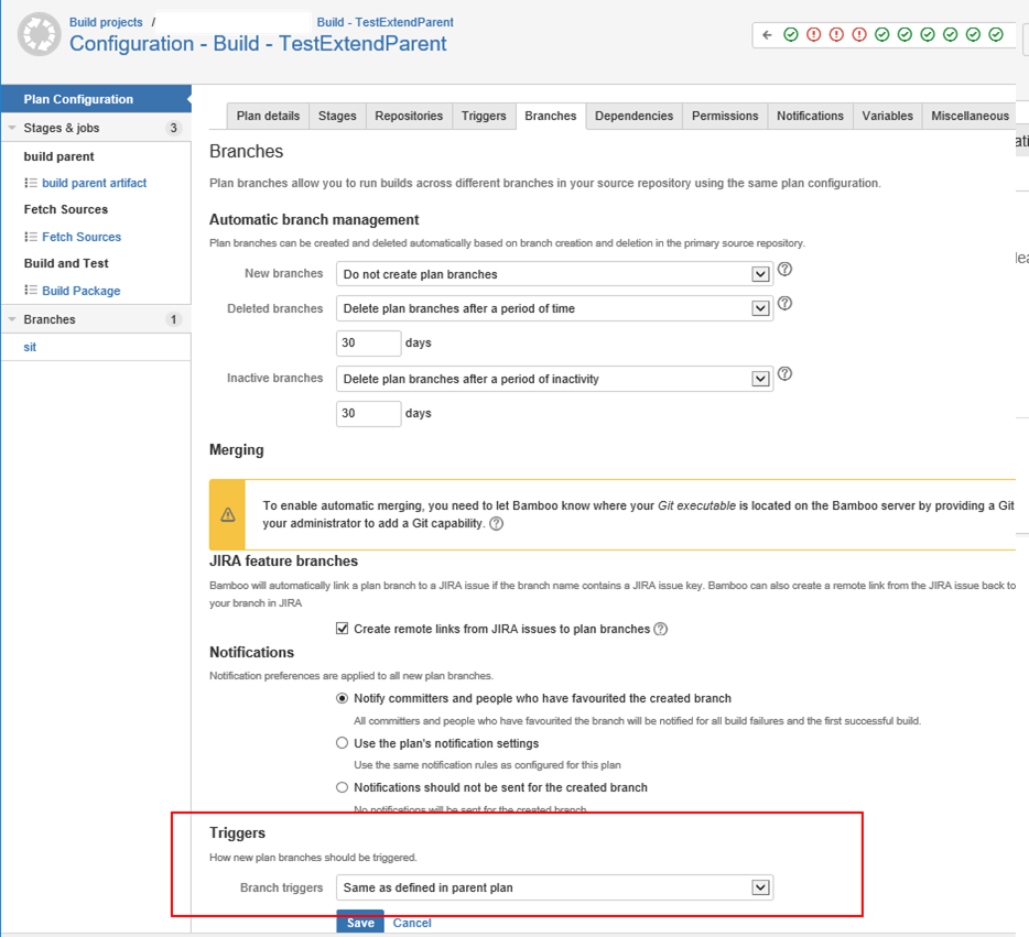

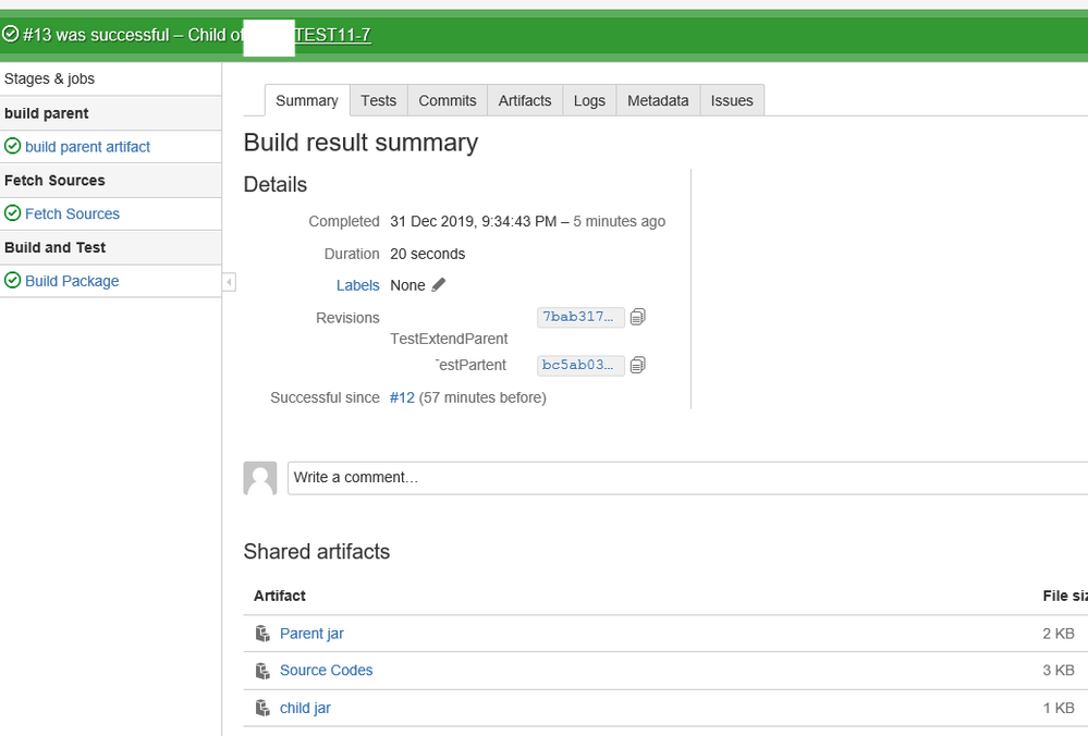

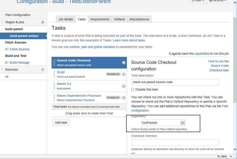

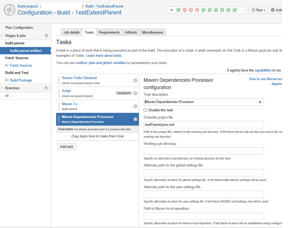

Hi Jimmy,
We try to follow your guideline but still cannot achieve the ultimate result.
I upload some screens and hope you can advise which part(s) go wrong
We setup two simple projects, one is TestParent, another project is TestExtendParent
and TestExtendParent depends on TestParent project in build process.
We setup one "sit" and one "develop" branch in both projects.
However, when TestParent build success on sit branch, it sets auto trigger to child plan (i.e. TestExtendParent), it suppose to download source from "sit" branch of TestParent.
However, when build with TestExtendParent, the source code of "TestParent" is "develop"
Hope following screen can let you understand what thing I set wrong.
Many thanks for your help in advance,
RaY

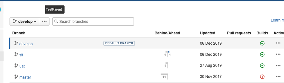

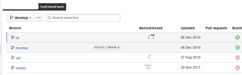

Hi Jimmy,
Yes, checked and both projects are having "develop" as default branch.
When building "sit" branch in parent project (i.e. our project name is TestParent),
it will auto trigger child project (i.e. our project name is TestExtendParent)
In building TestExtendParent, it gets "develop" branch of parent project to build a shared artifact to use as further build for child project. I will provide screen captures in following.
Thanks,

plan-128647432-UT-13 (Child) - Build Final jar :
simple 31-Dec-2019 21:34:31 Build GN16 Inforce Illustration - Build - TestExtendParent - sit - Build Package #13 (HINF-BUILDTEST21-UT-13) started building on agent Default Agent
simple 31-Dec-2019 21:34:31 Build working directory is D:\atlassian\bamboo-home\xml-data\build-dir\HINF-BUILDTEST21-UT
simple 31-Dec-2019 21:34:31 Executing build GN16 Inforce Illustration - Build - TestExtendParent - sit - Build Package #13 (HINF-BUILDTEST21-UT-13)
simple 31-Dec-2019 21:34:31 Preparing artifact 'Parent jar' for use at ./testExtendParent/lib/
simple 31-Dec-2019 21:34:31 Artifact 'Parent jar' prepared in 18.59 ms at D:\atlassian\bamboo-home\xml-data\build-dir\HINF-BUILDTEST21-UT\testExtendParent\lib\testParent-0.0.1-SNAPSHOT.jar
simple 31-Dec-2019 21:34:31 Preparing artifact 'Source Codes' for use at ./
simple 31-Dec-2019 21:34:31 Artifact 'Source Codes' prepared in 130.7 ms at D:\atlassian\bamboo-home\xml-data\build-dir\HINF-BUILDTEST21-UT
simple 31-Dec-2019 21:34:31 Running pre-build action: VCS Version Collector
simple 31-Dec-2019 21:34:31 Starting task 'Package jar' of type 'com.atlassian.bamboo.plugins.maven:task.builder.mvn3'
command 31-Dec-2019 21:34:31 Beginning to execute external process for build 'GN16 Inforce Illustration - Build - TestExtendParent - sit - Build Package #13 (HINF-BUILDTEST21-UT-13)'\n ... running command line: \nD:\Tools\apache-maven-3.1.1\bin\mvn.bat --batch-mode -Djava.io.tmpdir=D:\atlassian\Bamboo\temp\HINF-BUILDTEST21-UT -f testExtendParent\pom.xml clean install\n ... in: D:\atlassian\bamboo-home\xml-data\build-dir\HINF-BUILDTEST21-UT\n ... using extra environment variables: \nbamboo_planRepository_1_branch=sit\nbamboo_dependency_parent_0=HINF-TEST11-7\nbamboo_artifacts_path_Source_Codes=\nbamboo_planRepository_2_branch=develop\nbamboo_dependency_parent_total=1\nbamboo_repository_revision_number=7bab317765b9a06c3198ce2f36eaa9bf91e75ca5\nMAVEN2_HOME=D:\Tools\apache-maven-3.1.1\nbamboo_resultsUrl=http://aiahk-bamboo.aia.biz/browse/HINF-BUILDTEST21-UT-13\nbamboo_capability_system_builder_msbuild_MSBuild_v4_0__32bit_=C:\Windows\Microsoft.NET\Framework\v4.0.30319\MSBuild.exe\nbamboo_repository_119177359_git_branch=develop\nbamboo_internetUATUserId=huatdpy\nbamboo_repository_128843882_git_branch=sit\nbamboo_planRepository_1_name=GN16 TestExtendParent\nbamboo_build_working_directory=D:\atlassian\bamboo-home\xml-data\build-dir\HINF-BUILDTEST21-UT\nbamboo_buildKey=HINF-BUILDTEST21-UT\nbamboo_repository_119177359_previous_revision_number=bc5ab0396b61b4648a47297d0c2b3b2df0995198\nbamboo_repository_128843882_branch_name=sit\nbamboo_shortPlanName=sit\nbamboo_capability_system_builder_command_Websphere_8_0_Admin_Client=D:\Tools\WAS80_Thin_Client\wsadmin.bat\nbamboo_capability_system_builder_msbuild_MSBuild_v3_5__64bit_=C:\Windows\Microsoft.NET\Framework64\v3.5\MSBuild.exe\nbamboo_planRepository_2_username=\nbamboo_repository_119177359_revision_number=bc5ab0396b61b4648a47297d0c2b3b2df0995198\nbamboo_planRepository_name=GN16 TestExtendParent\nbamboo_repository_119177359_git_repositoryUrl=ssh://git@aiahk-stash.aia.biz:7999/gn16_ii/testparent.git\nbamboo_buildNumber=13\nbamboo_repository_119177359_git_username=\nbamboo_shortJobName=Build Package\nbamboo_capability_system_jdk_WebSphere_JDK_8=D:\Tools\WebSphere 8.0 JDK\nbamboo_capability_system_builder_mvn3_Maven_3_1_1=D:\Tools\apache-maven-3.1.1\nbamboo_buildResultsUrl=http://aiahk-bamboo.aia.biz/browse/HINF-BUILDTEST21-UT-13\nbamboo_capability_system_builder_msbuild_MSBuild_v2_0__64bit_=C:\Windows\Microsoft.NET\Framework64\v2.0.50727\MSBuild.exe\nbamboo_planRepository_repositoryUrl=ssh://git@aiahk-stash.aia.biz:7999/gn16_ii/testextendparent.git\nbamboo_capability_system_jdk_JDK_8_Update_25=D:\Tools\Java\jdk1.8.0_25\nbamboo_agentId=131073\nbamboo_planName=GN16 Inforce Illustration - Build - TestExtendParent - sit\nbamboo_shortPlanKey=BUILDTEST21\nbamboo_shortJobKey=UT\nbamboo_planRepository_2_name=Gn16 TestPartent\nbamboo_planRepository_revision=7bab317765b9a06c3198ce2f36eaa9bf91e75ca5\nbamboo_capability_system_jdk_JDK_1_7_0_67=C:\Program Files\Java\jre7\nbamboo_repository_previous_revision_number=7bab317765b9a06c3198ce2f36eaa9bf91e75ca5\nbamboo_buildTimeStamp=2019-12-31T21:34:31.455+08:00\nbamboo_planRepository_previousRevision=7bab317765b9a06c3198ce2f36eaa9bf91e75ca5\nbamboo_repository_128843882_git_username=\nM2_HOME=D:\Tools\apache-maven-3.1.1\nbamboo_repository_128843882_git_repositoryUrl=ssh://git@aiahk-stash.aia.biz:7999/gn16_ii/testextendparent.git\nbamboo_buildResultKey=HINF-BUILDTEST21-UT-13\nbamboo_repository_git_branch=sit\nbamboo_repository_branch_name=sit\nbamboo_buildPlanName=GN16 Inforce Illustration - Build - TestExtendParent - sit - Build Package\nbamboo_BRANCH=sit\nbamboo_planRepository_1_revision=7bab317765b9a06c3198ce2f36eaa9bf91e75ca5\nbamboo_capability_system_jdk_JDK_8_1_8_0_172=D:\Tools\Java\jdk1.8.0_172\nbamboo_capability_system_builder_msbuild_MSBuild_v2_0__32bit_=C:\Windows\Microsoft.NET\Framework\v2.0.50727\MSBuild.exe\nbamboo_deployUserId=huatdpy\nbamboo_repository_name=Gn16 TestPartent\nJAVA_HOME=D:\Tools\Java\jdk1.8.0_172\nbamboo_planRepository_2_previousRevision=bc5ab0396b61b4648a47297d0c2b3b2df0995198\nbamboo_capability_system_builder_msbuild_MSBuild_v3_5__32bit_=C:\Windows\Microsoft.NET\Framework\v3.5\MSBuild.exe\nbamboo_repository_128843882_name=GN16 TestExtendParent\nbamboo_planRepository_branch=sit\nbamboo_agentWorkingDirectory=D:\atlassian\bamboo-home\xml-data\build-dir\nbamboo_planRepository_2_revision=bc5ab0396b61b4648a47297d0c2b3b2df0995198\nbamboo_planRepository_1_previousRevision=7bab317765b9a06c3198ce2f36eaa9bf91e75ca5\nbamboo_repository_git_username=\nbamboo_capability_system_builder_mvn3_Maven_3_2_5=D:\Tools\apache-maven-3.2.5\nbamboo_capability_system_builder_command_Websphere_9_0_Admin_Client=D:\Tools\WAS9_Thin_Client_OracleJDK\wsadmin.bat\nbamboo_capability_system_builder_command_curl=D:\Tools\curl-7.66.0\bin\curl.exe\nbamboo_planRepository_1_type=stash-rep\nbamboo_planRepository_branchName=sit\nbamboo_planRepository_2_type=stash-rep\nbamboo_repository_128843882_previous_revision_number=7bab317765b9a06c3198ce2f36eaa9bf91e75ca5\nbamboo_planRepository_2_repositoryUrl=ssh://git@aiahk-stash.aia.biz:7999/gn16_ii/testparent.git\nbamboo_planRepository_type=stash-rep\nbamboo_planRepository_1_username=\nbamboo_repository_git_repositoryUrl=ssh://git@aiahk-stash.aia.biz:7999/gn16_ii/testextendparent.git\nbamboo_planRepository_2_branchName=develop\nbamboo_internetUATPassword=********\nbamboo_capability_system_builder_msbuild_MSBuild_v4_0__64bit_=C:\Windows\Microsoft.NET\Framework64\v4.0.30319\MSBuild.exe\nuseMavenReturnCode=false\nbamboo_working_directory=D:\atlassian\bamboo-home\xml-data\build-dir\HINF-BUILDTEST21-UT\nbamboo_planKey=HINF-BUILDTEST21\nbamboo_planRepository_1_repositoryUrl=ssh://git@aiahk-stash.aia.biz:7999/gn16_ii/testextendparent.git\nbamboo_planRepository_username=\nbamboo_repository_119177359_name=Gn16 TestPartent\nbamboo_repository_128843882_revision_number=7bab317765b9a06c3198ce2f36eaa9bf91e75ca5\nbamboo_deployPassword=********\nbamboo_repository_119177359_branch_name=develop\nbamboo_artifacts_path_Parent_jar=D:\atlassian\bamboo-home\xml-data\build-dir\HINF-BUILDTEST21-UT\testExtendParent\lib\testParent-0.0.1-SNAPSHOT.jar\nbamboo_planRepository_1_branchName=sit\nPath=D:\Tools\Java\jdk1.8.0_172\bin;C:\ProgramData\Oracle\Java\javapath;C:\Windows\system32;C:\Windows;C:\Windows\System32\Wbem;C:\Windows\System32\WindowsPowerShell\v1.0\;C:\Program Files\Microsoft Windows Performance Toolkit\;C:\IBM\ITM\bin;C:\IBM\ITM\InstallITM;C:\IBM\ITM\TMAITM6;C:\Program Files\Git\cmd;D:\Tools\curl-7.66.0\bin\n
build 31-Dec-2019 21:34:36 [INFO] Scanning for projects...
build 31-Dec-2019 21:34:36 [WARNING]
build 31-Dec-2019 21:34:36 [WARNING] Some problems were encountered while building the effective model for com.aiahk.application:testExtendParent:jar:0.0.1-SNAPSHOT
build 31-Dec-2019 21:34:36 [WARNING] 'dependencies.dependency.systemPath' for com.aiahk.product:testParent:jar should not point at files within the project directory, ${basedir}/lib/testParent-0.0.1-SNAPSHOT.jar will be unresolvable by dependent projects @ line 21, column 16
build 31-Dec-2019 21:34:36 [WARNING] It is highly recommended to fix these problems because they threaten the stability of your build.
build 31-Dec-2019 21:34:36 [WARNING] For this reason, future Maven versions might no longer support building such malformed projects.
build 31-Dec-2019 21:34:36 [INFO] ------------------------------------------------------------------------
build 31-Dec-2019 21:34:36 [INFO] Building testExtendParent 0.0.1-SNAPSHOT
build 31-Dec-2019 21:34:37 [INFO]
build 31-Dec-2019 21:34:37 [INFO] --- maven-clean-plugin:2.5:clean (default-clean) @ testExtendParent ---
build 31-Dec-2019 21:34:37 [INFO] Deleting D:\atlassian\bamboo-home\xml-data\build-dir\HINF-BUILDTEST21-UT\testExtendParent\target
build 31-Dec-2019 21:34:37 [INFO] --- maven-resources-plugin:2.6:resources (default-resources) @ testExtendParent ---
build 31-Dec-2019 21:34:37 [WARNING] Using platform encoding (Cp1252 actually) to copy filtered resources, i.e. build is platform dependent!
build 31-Dec-2019 21:34:37 [INFO] skip non existing resourceDirectory D:\atlassian\bamboo-home\xml-data\build-dir\HINF-BUILDTEST21-UT\testExtendParent\src\main\resources
build 31-Dec-2019 21:34:37 [INFO] --- maven-compiler-plugin:2.5.1:compile (default-compile) @ testExtendParent ---
build 31-Dec-2019 21:34:37 [WARNING] File encoding has not been set, using platform encoding Cp1252, i.e. build is platform dependent!
build 31-Dec-2019 21:34:37 [INFO] Compiling 1 source file to D:\atlassian\bamboo-home\xml-data\build-dir\HINF-BUILDTEST21-UT\testExtendParent\target\classes
build 31-Dec-2019 21:34:39 [INFO]
build 31-Dec-2019 21:34:39 [INFO] --- maven-resources-plugin:2.6:testResources (default-testResources) @ testExtendParent ---
build 31-Dec-2019 21:34:39 [WARNING] Using platform encoding (Cp1252 actually) to copy filtered resources, i.e. build is platform dependent!
build 31-Dec-2019 21:34:39 [INFO] skip non existing resourceDirectory D:\atlassian\bamboo-home\xml-data\build-dir\HINF-BUILDTEST21-UT\testExtendParent\src\test\resources
build 31-Dec-2019 21:34:39 [INFO] --- maven-compiler-plugin:2.5.1:testCompile (default-testCompile) @ testExtendParent ---
build 31-Dec-2019 21:34:39 [WARNING] File encoding has not been set, using platform encoding Cp1252, i.e. build is platform dependent!
build 31-Dec-2019 21:34:39 [INFO] Compiling 1 source file to D:\atlassian\bamboo-home\xml-data\build-dir\HINF-BUILDTEST21-UT\testExtendParent\target\test-classes
build 31-Dec-2019 21:34:39 [INFO] --- maven-surefire-plugin:2.12.4:test (default-test) @ testExtendParent ---
build 31-Dec-2019 21:34:39 [INFO] Surefire report directory: D:\atlassian\bamboo-home\xml-data\build-dir\HINF-BUILDTEST21-UT\testExtendParent\target\surefire-reports
build 31-Dec-2019 21:34:40
build 31-Dec-2019 21:34:40 -------------------------------------------------------
build 31-Dec-2019 21:34:40 T E S T S
build 31-Dec-2019 21:34:41 Running testExtendParent.StringUtilTest
build 31-Dec-2019 21:34:41 Hellow world! DEV
build 31-Dec-2019 21:34:41 Tests run: 1, Failures: 0, Errors: 0, Skipped: 0, Time elapsed: 0.047 sec
build 31-Dec-2019 21:34:41 Results :
build 31-Dec-2019 21:34:41 [INFO]
build 31-Dec-2019 21:34:41 [INFO] --- maven-jar-plugin:2.3.1:jar (default-jar) @ testExtendParent ---
build 31-Dec-2019 21:34:41 [INFO] Building jar: D:\atlassian\bamboo-home\xml-data\build-dir\HINF-BUILDTEST21-UT\testExtendParent\target\testExtendParent-0.0.1-SNAPSHOT.jar
build 31-Dec-2019 21:34:41 [INFO] --- maven-install-plugin:2.4:install (default-install) @ testExtendParent ---
build 31-Dec-2019 21:34:42 [INFO] Installing D:\atlassian\bamboo-home\xml-data\build-dir\HINF-BUILDTEST21-UT\testExtendParent\target\testExtendParent-0.0.1-SNAPSHOT.jar to C:\Users\HPALT01\.m2\repository\com\aiahk\application\testExtendParent\0.0.1-SNAPSHOT\testExtendParent-0.0.1-SNAPSHOT.jar
build 31-Dec-2019 21:34:42 [INFO] Installing D:\atlassian\bamboo-home\xml-data\build-dir\HINF-BUILDTEST21-UT\testExtendParent\pom.xml to C:\Users\HPALT01\.m2\repository\com\aiahk\application\testExtendParent\0.0.1-SNAPSHOT\testExtendParent-0.0.1-SNAPSHOT.pom
build 31-Dec-2019 21:34:42 [INFO] ------------------------------------------------------------------------
build 31-Dec-2019 21:34:42 [INFO] BUILD SUCCESS
build 31-Dec-2019 21:34:42 [INFO] Total time: 6.446s
build 31-Dec-2019 21:34:42 [INFO] Finished at: Tue Dec 31 21:34:42 CST 2019
build 31-Dec-2019 21:34:42 [INFO] Final Memory: 14M/150M
simple 31-Dec-2019 21:34:42 Finished task 'Package jar' with result: Success
simple 31-Dec-2019 21:34:42 Running post build plugin 'NCover Results Collector'
simple 31-Dec-2019 21:34:42 Running post build plugin 'Artifact Copier'
simple 31-Dec-2019 21:34:42 Publishing an artifact: child jar
simple 31-Dec-2019 21:34:42 Finished publishing of artifact Shared artifact: [child jar], pattern: [**/*.jar] anchored at: [testExtendParent/target/] in 11.18 ms
simple 31-Dec-2019 21:34:42 Running post build plugin 'npm Cache Cleanup'
simple 31-Dec-2019 21:34:42 Running post build plugin 'Clover Results Collector'
simple 31-Dec-2019 21:34:42 Running post build plugin 'Docker Container Cleanup'
simple 31-Dec-2019 21:34:42 Successfully removed working directory at 'D:\atlassian\bamboo-home\xml-data\build-dir\HINF-BUILDTEST21-UT'
simple 31-Dec-2019 21:34:42 Finalising the build...
simple 31-Dec-2019 21:34:42 Stopping timer.
simple 31-Dec-2019 21:34:42 Build HINF-BUILDTEST21-UT-13 completed.
simple 31-Dec-2019 21:34:42 Running on server: post build plugin 'NCover Results Collector'
simple 31-Dec-2019 21:34:42 Running on server: post build plugin 'Build Hanging Detection Configuration'
simple 31-Dec-2019 21:34:42 Running on server: post build plugin 'Clover Delta Calculator'
simple 31-Dec-2019 21:34:42 Running on server: post build plugin 'Maven Dependencies Postprocessor'
simple 31-Dec-2019 21:34:42 All post build plugins have finished
simple 31-Dec-2019 21:34:42 Generating build results summary...
simple 31-Dec-2019 21:34:42 Saving build results to disk...
simple 31-Dec-2019 21:34:42 Logging substituted variables...
simple 31-Dec-2019 21:34:42 Indexing build results...
simple 31-Dec-2019 21:34:42 Finished building HINF-BUILDTEST21-UT-13.
plan-128647432-BPA-13 (Child) - Build Parent jar log
simple 31-Dec-2019 21:34:22 Build GN16 Inforce Illustration - Build - TestExtendParent - sit - build parent artifact #13 (HINF-BUILDTEST21-BPA-13) started building on agent Local Agent 1
simple 31-Dec-2019 21:34:22 Build working directory is D:\atlassian\bamboo-home\xml-data\build-dir\HINF-BUILDTEST21-BPA
simple 31-Dec-2019 21:34:22 Executing build GN16 Inforce Illustration - Build - TestExtendParent - sit - build parent artifact #13 (HINF-BUILDTEST21-BPA-13)
simple 31-Dec-2019 21:34:22 Starting task 'check out parent source code' of type 'com.atlassian.bamboo.plugins.vcs:task.vcs.checkout'
simple 31-Dec-2019 21:34:22 Build always requires a clean checkout
simple 31-Dec-2019 21:34:22 Cleaning build directory 'D:\atlassian\bamboo-home\xml-data\build-dir\HINF-BUILDTEST21-BPA'
simple 31-Dec-2019 21:34:22 Updating source code to revision: bc5ab0396b61b4648a47297d0c2b3b2df0995198
simple 31-Dec-2019 21:34:22 Fetching 'refs/heads/*' from 'ssh://git@aiahk-stash.aia.biz:7999/gn16_ii/testparent.git'.
simple 31-Dec-2019 21:34:22 Git: Updating references
simple 31-Dec-2019 21:34:22 Checking out revision bc5ab0396b61b4648a47297d0c2b3b2df0995198.
simple 31-Dec-2019 21:34:22 Creating local git repository in 'D:\atlassian\bamboo-home\xml-data\build-dir\HINF-BUILDTEST21-BPA\.git'.
simple 31-Dec-2019 21:34:23 Updated source code to revision: bc5ab0396b61b4648a47297d0c2b3b2df0995198
simple 31-Dec-2019 21:34:23 Finished task 'check out parent source code' with result: Success
simple 31-Dec-2019 21:34:23 Running pre-build action: VCS Version Collector
simple 31-Dec-2019 21:34:23 Skipping execution of task 'check out parent branch' as it is disabled
simple 31-Dec-2019 21:34:23 Starting task 'build parent' of type 'com.atlassian.bamboo.plugins.maven:task.builder.mvn3'
command 31-Dec-2019 21:34:23 Beginning to execute external process for build 'GN16 Inforce Illustration - Build - TestExtendParent - sit - build parent artifact #13 (HINF-BUILDTEST21-BPA-13)'\n ... running command line: \nD:\Tools\apache-maven-3.1.1\bin\mvn.bat --batch-mode -Djava.io.tmpdir=D:\atlassian\Bamboo\temp\HINF-BUILDTEST21-BPA -f testParent\pom.xml clean package\n ... in: D:\atlassian\bamboo-home\xml-data\build-dir\HINF-BUILDTEST21-BPA\n ... using extra environment variables: \nbamboo_planRepository_1_branch=sit\nbamboo_dependency_parent_0=HINF-TEST11-7\nbamboo_planRepository_2_branch=develop\nbamboo_dependency_parent_total=1\nbamboo_repository_revision_number=7bab317765b9a06c3198ce2f36eaa9bf91e75ca5\nMAVEN2_HOME=D:\Tools\apache-maven-3.1.1\nbamboo_resultsUrl=http://aiahk-bamboo.aia.biz/browse/HINF-BUILDTEST21-BPA-13\nbamboo_capability_system_builder_msbuild_MSBuild_v4_0__32bit_=C:\Windows\Microsoft.NET\Framework\v4.0.30319\MSBuild.exe\nbamboo_repository_119177359_git_branch=develop\nbamboo_internetUATUserId=huatdpy\nbamboo_repository_128843882_git_branch=sit\nbamboo_planRepository_1_name=GN16 TestExtendParent\nbamboo_build_working_directory=D:\atlassian\bamboo-home\xml-data\build-dir\HINF-BUILDTEST21-BPA\nbamboo_buildKey=HINF-BUILDTEST21-BPA\nbamboo_repository_119177359_previous_revision_number=bc5ab0396b61b4648a47297d0c2b3b2df0995198\nbamboo_repository_128843882_branch_name=sit\nbamboo_shortPlanName=sit\nbamboo_capability_system_builder_command_Websphere_8_0_Admin_Client=D:\Tools\WAS80_Thin_Client\wsadmin.bat\nbamboo_capability_system_builder_msbuild_MSBuild_v3_5__64bit_=C:\Windows\Microsoft.NET\Framework64\v3.5\MSBuild.exe\nbamboo_planRepository_2_username=\nbamboo_repository_119177359_revision_number=bc5ab0396b61b4648a47297d0c2b3b2df0995198\nbamboo_planRepository_name=GN16 TestExtendParent\nbamboo_repository_119177359_git_repositoryUrl=ssh://git@aiahk-stash.aia.biz:7999/gn16_ii/testparent.git\nbamboo_buildNumber=13\nbamboo_repository_119177359_git_username=\nbamboo_shortJobName=build parent artifact\nbamboo_capability_system_jdk_WebSphere_JDK_8=D:\Tools\WebSphere 8.0 JDK\nbamboo_capability_system_builder_mvn3_Maven_3_1_1=D:\Tools\apache-maven-3.1.1\nbamboo_buildResultsUrl=http://aiahk-bamboo.aia.biz/browse/HINF-BUILDTEST21-BPA-13\nbamboo_capability_system_builder_msbuild_MSBuild_v2_0__64bit_=C:\Windows\Microsoft.NET\Framework64\v2.0.50727\MSBuild.exe\nbamboo_planRepository_repositoryUrl=ssh://git@aiahk-stash.aia.biz:7999/gn16_ii/testextendparent.git\nbamboo_capability_system_jdk_JDK_8_Update_25=D:\Tools\Java\jdk1.8.0_25\nbamboo_agentId=1638401\nbamboo_planName=GN16 Inforce Illustration - Build - TestExtendParent - sit\nbamboo_shortPlanKey=BUILDTEST21\nbamboo_shortJobKey=BPA\nbamboo_planRepository_2_name=Gn16 TestPartent\nbamboo_planRepository_revision=7bab317765b9a06c3198ce2f36eaa9bf91e75ca5\nbamboo_capability_system_jdk_JDK_1_7_0_67=C:\Program Files\Java\jre7\nbamboo_repository_previous_revision_number=7bab317765b9a06c3198ce2f36eaa9bf91e75ca5\nbamboo_buildTimeStamp=2019-12-31T21:34:22.002+08:00\nbamboo_planRepository_previousRevision=7bab317765b9a06c3198ce2f36eaa9bf91e75ca5\nbamboo_repository_128843882_git_username=\nM2_HOME=D:\Tools\apache-maven-3.1.1\nbamboo_repository_128843882_git_repositoryUrl=ssh://git@aiahk-stash.aia.biz:7999/gn16_ii/testextendparent.git\nbamboo_buildResultKey=HINF-BUILDTEST21-BPA-13\nbamboo_repository_git_branch=sit\nbamboo_repository_branch_name=sit\nbamboo_buildPlanName=GN16 Inforce Illustration - Build - TestExtendParent - sit - build parent artifact\nbamboo_BRANCH=sit\nbamboo_planRepository_1_revision=7bab317765b9a06c3198ce2f36eaa9bf91e75ca5\nbamboo_capability_system_jdk_JDK_8_1_8_0_172=D:\Tools\Java\jdk1.8.0_172\nbamboo_capability_system_builder_msbuild_MSBuild_v2_0__32bit_=C:\Windows\Microsoft.NET\Framework\v2.0.50727\MSBuild.exe\nbamboo_deployUserId=huatdpy\nbamboo_repository_name=Gn16 TestPartent\nJAVA_HOME=D:\Tools\WebSphere 8.0 JDK\nbamboo_planRepository_2_previousRevision=bc5ab0396b61b4648a47297d0c2b3b2df0995198\nbamboo_capability_system_builder_msbuild_MSBuild_v3_5__32bit_=C:\Windows\Microsoft.NET\Framework\v3.5\MSBuild.exe\nbamboo_repository_128843882_name=GN16 TestExtendParent\nbamboo_planRepository_branch=sit\nbamboo_agentWorkingDirectory=D:\atlassian\bamboo-home\xml-data\build-dir\nbamboo_planRepository_2_revision=bc5ab0396b61b4648a47297d0c2b3b2df0995198\nbamboo_planRepository_1_previousRevision=7bab317765b9a06c3198ce2f36eaa9bf91e75ca5\nbamboo_repository_git_username=\nbamboo_capability_system_builder_mvn3_Maven_3_2_5=D:\Tools\apache-maven-3.2.5\nbamboo_capability_system_builder_command_Websphere_9_0_Admin_Client=D:\Tools\WAS9_Thin_Client_OracleJDK\wsadmin.bat\nbamboo_capability_system_builder_command_curl=D:\Tools\curl-7.66.0\bin\curl.exe\nbamboo_planRepository_1_type=stash-rep\nbamboo_planRepository_branchName=sit\nbamboo_planRepository_2_type=stash-rep\nbamboo_repository_128843882_previous_revision_number=7bab317765b9a06c3198ce2f36eaa9bf91e75ca5\nbamboo_planRepository_2_repositoryUrl=ssh://git@aiahk-stash.aia.biz:7999/gn16_ii/testparent.git\nbamboo_planRepository_type=stash-rep\nbamboo_planRepository_1_username=\nbamboo_repository_git_repositoryUrl=ssh://git@aiahk-stash.aia.biz:7999/gn16_ii/testextendparent.git\nbamboo_planRepository_2_branchName=develop\nbamboo_internetUATPassword=********\nbamboo_capability_system_builder_msbuild_MSBuild_v4_0__64bit_=C:\Windows\Microsoft.NET\Framework64\v4.0.30319\MSBuild.exe\nuseMavenReturnCode=true\nbamboo_working_directory=D:\atlassian\bamboo-home\xml-data\build-dir\HINF-BUILDTEST21-BPA\nbamboo_planKey=HINF-BUILDTEST21\nbamboo_planRepository_1_repositoryUrl=ssh://git@aiahk-stash.aia.biz:7999/gn16_ii/testextendparent.git\nbamboo_planRepository_username=\nbamboo_repository_119177359_name=Gn16 TestPartent\nbamboo_repository_128843882_revision_number=7bab317765b9a06c3198ce2f36eaa9bf91e75ca5\nbamboo_deployPassword=********\nbamboo_repository_119177359_branch_name=develop\nbamboo_planRepository_1_branchName=sit\nPath=D:\Tools\WebSphere 8.0 JDK\bin;C:\ProgramData\Oracle\Java\javapath;C:\Windows\system32;C:\Windows;C:\Windows\System32\Wbem;C:\Windows\System32\WindowsPowerShell\v1.0\;C:\Program Files\Microsoft Windows Performance Toolkit\;C:\IBM\ITM\bin;C:\IBM\ITM\InstallITM;C:\IBM\ITM\TMAITM6;C:\Program Files\Git\cmd;D:\Tools\curl-7.66.0\bin\n
build 31-Dec-2019 21:34:25 [INFO] Scanning for projects...
build 31-Dec-2019 21:34:26 [INFO]
build 31-Dec-2019 21:34:26 [INFO] ------------------------------------------------------------------------
build 31-Dec-2019 21:34:26 [INFO] Building testParent 0.0.1-SNAPSHOT
build 31-Dec-2019 21:34:26 [INFO] --- maven-clean-plugin:2.5:clean (default-clean) @ testParent ---
build 31-Dec-2019 21:34:26 [INFO] Deleting D:\atlassian\bamboo-home\xml-data\build-dir\HINF-BUILDTEST21-BPA\testParent\target
build 31-Dec-2019 21:34:26 [INFO] --- maven-resources-plugin:2.6:resources (default-resources) @ testParent ---
build 31-Dec-2019 21:34:26 [WARNING] Using platform encoding (Cp1252 actually) to copy filtered resources, i.e. build is platform dependent!
build 31-Dec-2019 21:34:26 [INFO] skip non existing resourceDirectory D:\atlassian\bamboo-home\xml-data\build-dir\HINF-BUILDTEST21-BPA\testParent\src\main\resources
build 31-Dec-2019 21:34:26 [INFO] --- maven-compiler-plugin:2.1:compile (default-compile) @ testParent ---
build 31-Dec-2019 21:34:26 [WARNING] File encoding has not been set, using platform encoding Cp1252, i.e. build is platform dependent!
build 31-Dec-2019 21:34:26 [INFO] Compiling 1 source file to D:\atlassian\bamboo-home\xml-data\build-dir\HINF-BUILDTEST21-BPA\testParent\target\classes
build 31-Dec-2019 21:34:27 [INFO]
build 31-Dec-2019 21:34:27 [INFO] --- maven-resources-plugin:2.6:testResources (default-testResources) @ testParent ---
build 31-Dec-2019 21:34:27 [WARNING] Using platform encoding (Cp1252 actually) to copy filtered resources, i.e. build is platform dependent!
build 31-Dec-2019 21:34:27 [INFO] skip non existing resourceDirectory D:\atlassian\bamboo-home\xml-data\build-dir\HINF-BUILDTEST21-BPA\testParent\src\test\resources
build 31-Dec-2019 21:34:27 [INFO] --- maven-compiler-plugin:2.1:testCompile (default-testCompile) @ testParent ---
build 31-Dec-2019 21:34:27 [INFO] No sources to compile
build 31-Dec-2019 21:34:27 [INFO] --- maven-surefire-plugin:2.12.4:test (default-test) @ testParent ---
build 31-Dec-2019 21:34:27 [INFO] No tests to run.
build 31-Dec-2019 21:34:27 [INFO] --- maven-jar-plugin:2.4:jar (default-jar) @ testParent ---
build 31-Dec-2019 21:34:28 [INFO] Building jar: D:\atlassian\bamboo-home\xml-data\build-dir\HINF-BUILDTEST21-BPA\testParent\target\testParent-0.0.1-SNAPSHOT.jar
build 31-Dec-2019 21:34:28 [INFO] ------------------------------------------------------------------------
build 31-Dec-2019 21:34:28 [INFO] BUILD SUCCESS

Hi Jimmy,
I found that I cannot put the log output in this thread as it exceeds 20000 characters
Would you suggest what ways I can put the bamboo log here ?
Thanks,
Hey Ray,
Thanks for making log files available I found something that might explain this.
So looking at the variables that are being set for each task in the build, I wanted to see what Bamboo thinks the branch is suppose to be.
Here is what is being set for the TestParent build in the log:
That is exactly what we expect to see, and it doesn't look like there is any other repository (again expected) so TestParent is doing exactly what we want it to and what we expect it to do.
Now, if we look at the TestExtendParent build log:
We see that it is doing the same branch (which would indicate that Bamboo "thinks" it's running against the correct branch). Now this is where things get interesting, becuase I also saw this:
That indicates to me that you have a second repository configured in the TestExtendParent build plan that doesn't exist in the TestParent plan, that is executing against the 'develop' branch. Is it possible that this is placing source code in the same location as the first repo and overwriting the code that was checked out there? I would be looking at exactly what this second repository is doing because I think that is what is causing your issues at this point.
I hope that helps!
-Jimmy
Thanks Jimmy on your deep investigation. Let me to explain in more details on what we configure on TestParent plan and TestExtendParent as follows:
TestExtendParent requires to use TestParent artifact jar to build (i.e. TestExtendParent depends on TestParent), so while bamboo starts to build TexstExtendParent, it tries to check out source code from TestParent project to build it (That's why you found that it checks out "develop" but not "sit" branch source code of TestParent)
Now Scenario like this:
(1) Build TestParent
(2) It has auto trigger on Build of TestExendParent
(3) Within TestExtendParent, it tries to check out source from TestParent
and build a shared artifact jar
(4) TestExtendParent uses the shared artifact jar to build its output
You may question why I do not use output a shared artifact directly from TestParent and use it in TestExtendParent, the reason is that we may sometimes need to manual build TestExtendParent without having TestParent to build.
Would you share me your advise or best practice to manage such parent and child projects build processes ?
I capture two screens to illustrate the plan within TestExtendParent and its check out source code from TestParent (there is no branch to specify for it)
Thanks for your advice in advance,
Ray
