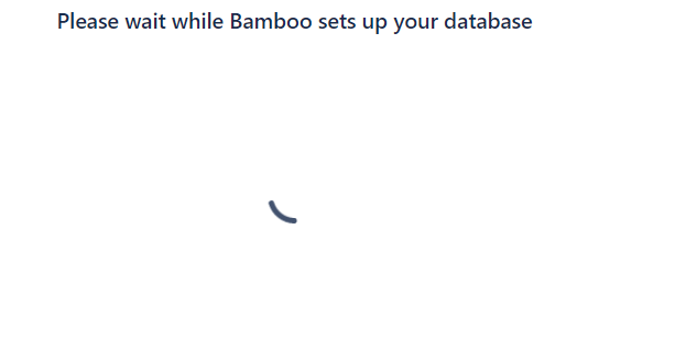

Stuck: Please wait while Bamboo sets up your database
Five Ten
November 28, 2022

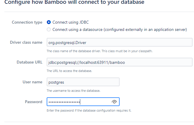

Run start-bamboo.bat, and got the following log. Then, stuck build database.
Could you please give your comemtns. ?

We need to see the rest of the log, or know that it has stopped logging anything while it tries to build the database.  Also, what errors are you getting on screen that makes you think it has stopped?

There is no other log.  I don't if postgres configuration right or not

Ok, that implies Bamboo has simply got stuck somewhere.  If it were your database settings, you would usually get a screen saying "can't access database" and an error message at the end of the log.
There's not much we can do without knowing what it is doing internally now, but if you were to stop it, give it a sec to shutdown properly, then restart it, you may get a different error message in the log, telling us what is broken (or it might just complete the job!)

We recently had a bug which caused failures when connecting to an unsupported database version to fail silently and present the endless spinner:
It may be that. What version of PostgreSQL are you connecting to? Bamboo 9.0 supports PostgreSQL 11, 12, 13 and 14.
