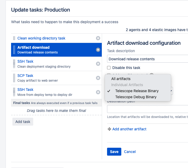

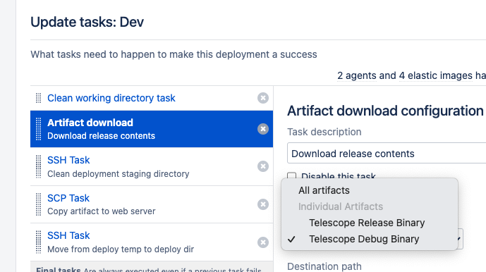

I have a build plan that generates two artifacts: DEBUG and RELEASE.
In my deployment plan, I'm setting up 2 environments, DEV and PROD. Both use identical steps to move build results to a web server - one of these steps is an SCP task.
When I setup DEV, the only artififact available to the SCP task is DEBUG.
When I try to setup PROD, the only option is "ALL ARTIFACTS."
I've checked and both artifacts are created successfully and have content after the latest build. On the Deployment Project page, both artifacts are listed as available.
Why can't I select specific artifacts for one environment? Why is only one artifact selectable for the other environment?

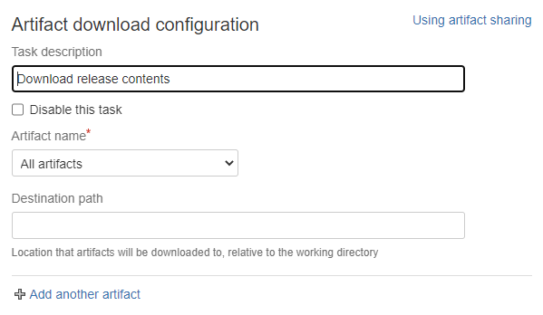

Angelo Pluskwa
June 1, 2022
Just wanted to say, that we have exctly the same issue.
Angelo Pluskwa
June 1, 2022
In my case I forgot to configure individual artifact downloads.
Like Steffen Opel [Utoolity] likes this
Bob Rzadzki
June 2, 2022
This was it! I selected the specific artifact in the Artifact Download task and it became available in the SCP task.
Thanks, Angelo!
Alexey Chystoprudov
May 26, 2022
hi, I was not able to reproduce issue. Applied your Specs to Bamboo 8.2.4 and everything looks ok. I can choose any artifact for any environment
Dev environment
Production environment
What if you try to achieve same config by Specs, does it work?
