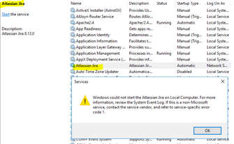

Hi Team,
Bamboo runs fine from the Console and Command Prompt. Service appears to be installed correctly, but will not start or an error shows up when trying to run it. While trying to set Bamboo as ''Service", following error comes up.

the error message seems to be suggesting more information could be found from system event log - that means: using Event Viewer you could probably get more information. Have you had the chance to check if this holds true?

It same with JIRA too.
