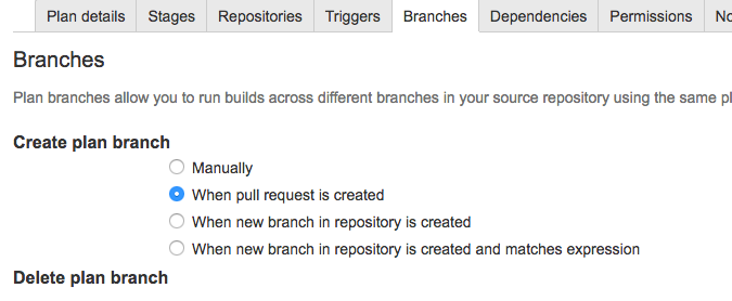

When you use option to create plan branch when PR created Screen Shot 2017-07-20 at 12.22.08.pngBamboo automatically creates plan branch linked to that PR. As I understand you already have this configuration.

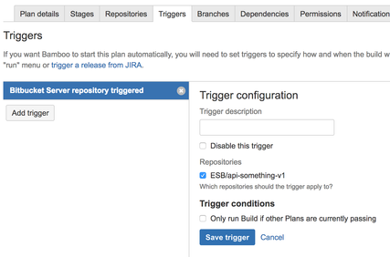

Then when you make a commit to the same branch Bamboo should build that branch as usual. If it doesn't happen please check your Trigger configuration, it should be like this:

Out of interest, why do you have more options in your screenshot than I do, on Trigger conditions:
Screen Shot 2017-07-20 at 9.53.57 pm.pngI am using Bamboo 6.0.1 and Bitbucket Server 5.0.1.
Alexey Chystoprudov
July 21, 2017
We have few internal plugins to add trigger conditions, they're not production ready yet
