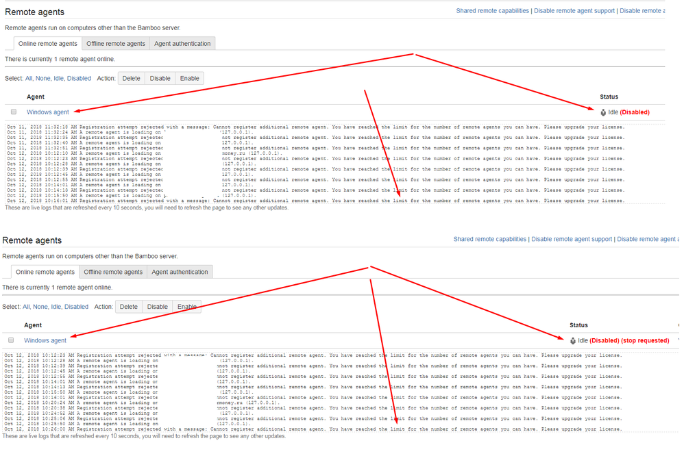

1. I try to disable active windows remote agent and reinstal linux remote agent, but problem is stay:
lis agent second.png2. I need to deploy project on remote linux host, so that i can't use local agent of bamboo server.

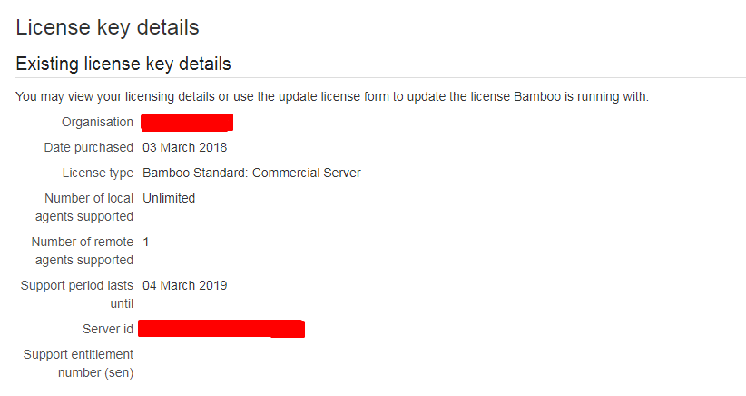

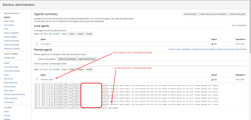

I have install remote agent on windows host and i want to install remote agent on linux host.
But agent on windows host took a license, so that linux remote agent can't connect to bamboo service (look at the second arrow)?
How can i run task on linux and windows host consistently? Now i can't run task on remote linux host, only on local linux agent or windows remote host agent.

As per screenshot provided, you can notice the Windows Agent is online. Because of that you cannot install a new Bamboo Remote Agent because your current license only allows you to have 1 remote agent up and running.
As previously mentioned, you first need to bring the Windows Agent down before attempting on installing the Linux Agent.
Your Bamboo Server is running on an Linux box (at least this is what the screenshot suggests based on Local Agent's name). Please, notice that Bamboo's server is also an agent capable of running builds, so you can run builds in Linux and Windows already without having to install a new Remote Agent.
Now, if you want to install a new remote agent you will have to follow the suggested, bringing 1 remote agent down in order to have the other remote agent up, becauase your current license only allows you to have 1 remote agent up.
