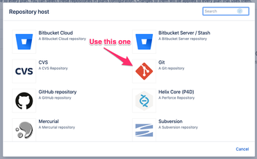

You will keep using the Bitbucket source repository, but in Bamboo side, you will use a different method for linking the repository. Instead of using the Bitbucket linking you will use the Git one as shown below:
Linked_repositories_-_Atlassian_Bamboo_-_Vivaldi.png:
More details on how to configure can be found here: Git - Atlassian Documentation.
Let me know if you have other questions in the meantime.
