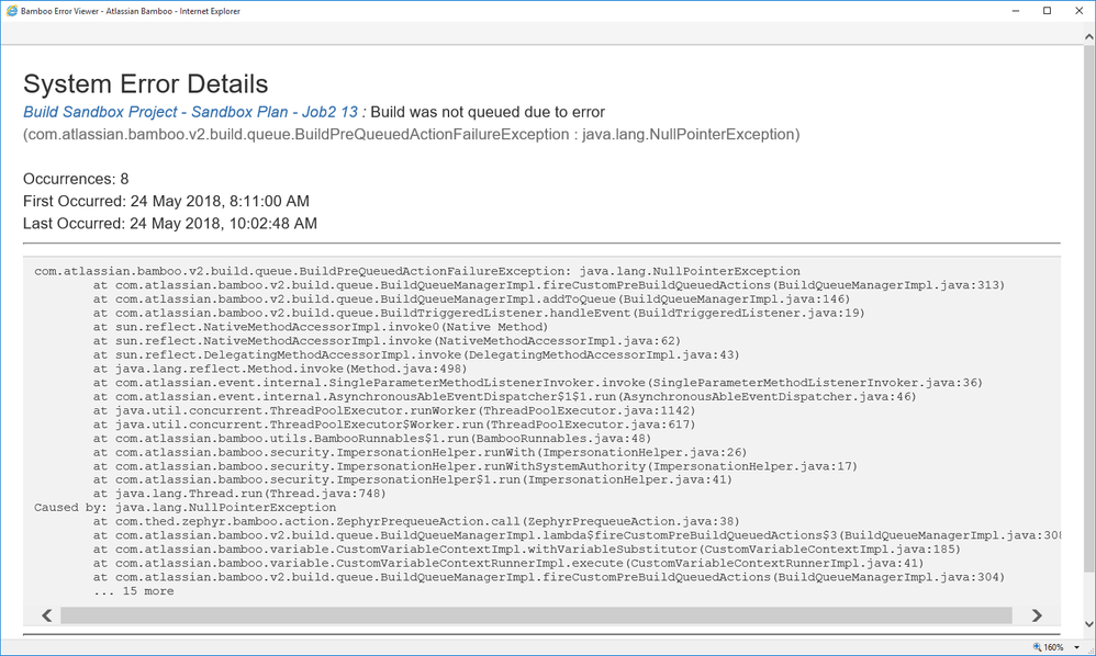

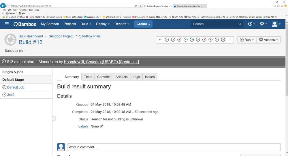

I created a simple Plan without any repositories and created a job and task. Task is a simple shell script. However, Bamboo (version 6.3.2) is not able to execute the task and fails with a message "# <build number> did not start" and in the error log section the message is "Build was not queued due to error"
Bamboo Error Viewer - Atlassian Bamboo
com.atlassian.bamboo.v2.build.queue.BuildPreQueuedActionFailureException: java.lang.NullPointerException
	at com.atlassian.bamboo.v2.build.queue.BuildQueueManagerImpl.fireCustomPreBuildQueuedActions(BuildQueueManagerImpl

Alexey Chystoprudov
May 24, 2018
Try to disable plugin from Zephyr, it should start working
Chandra Khandavalli
May 25, 2018
You nailed it down correctly, thanks a lot!!

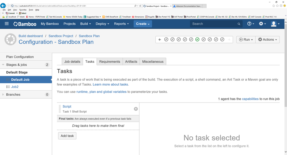

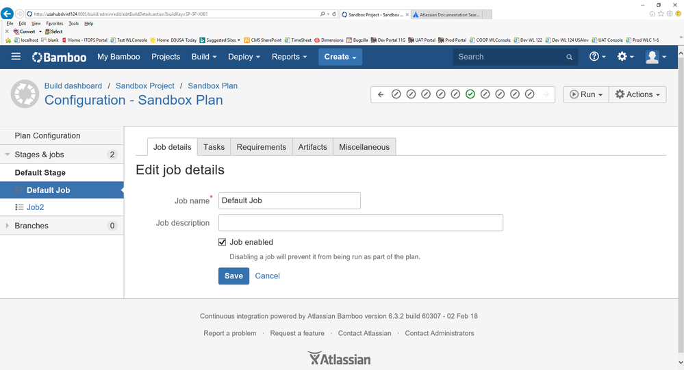

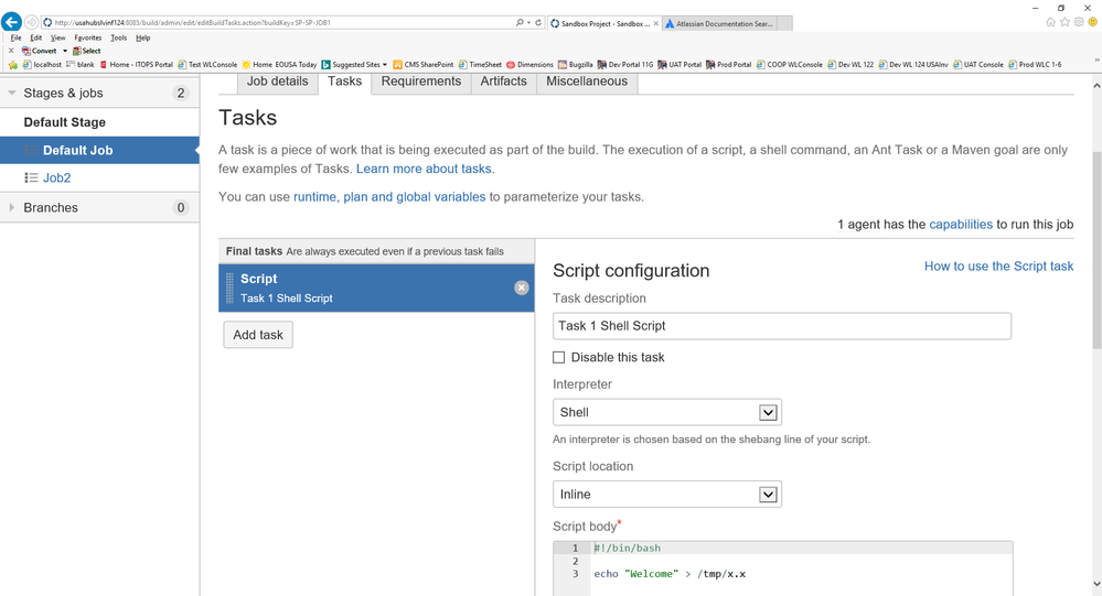

Yogesh Mude
May 24, 2018
HI @Chandra Khandavalli,
Can you attach the screenshot of the configuration what you have configured in Job and which task you have added to it.
If possible please share some logs.
Chandra Khandavalli
May 24, 2018
Yogesh Mude
May 24, 2018
Thanks for the sharing.
What executable is using for building this task?
Chandra Khandavalli
May 24, 2018
I am new user to the Bamboo. I did not associate or link any executable to the job/task. I simply created a plan with task type script with inline script. The script simply echoes text to a file. When I run the plan, I receive "Build was not queued due to error".
Is it necessary to associate this task to an executable? and how can it be done?

In my case, I think bamboo is not able to initiate and/or start the task.  It is failing before it can start the task and immaterial of what task I add I get the same error "Build was not queued due to error"
