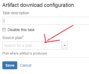

you should specify certain plan from which artefacts could be downloaded (correct for version 6.6.1). As a result, you can't use this trick for multiple plans.

Yes, Plan pipe should be able to download artifact from plan A and B. Then, generate artifacts again so that it can be downloaded in deployment environment.
