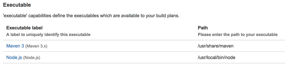

- As soon as I've installed, I've let my server to re-check its local agent capabilities:
Upper Right Cog --> Agents --> Server Capabilities...
And I got the server to recognise my node installation.

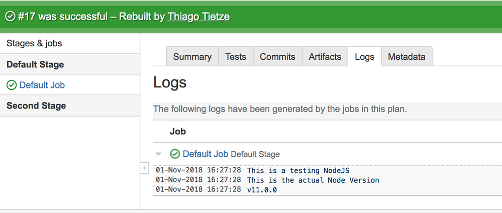

I've then proceeded to create a task to run a nodeJS script, so I could check If my node was working and on the right version. Something like this:
console.log('This is a testing NodeJS');
console.log('This is the actual Node Version');
console.log(process.version);
The result, while I run the task, is expected, as you can see at the task logs screen below:
- Since what we wanted was to update the actual node version, I've used npm and the 'n' module for that, with some little trick.

The recent stable version of node is v11.0.0. As soon as you update, since npm is supposed not to change default installation paths you should be able to view the updated version of node when you run the task again. Like I did:
I assume that the results would kinda be the same for remote agents.
