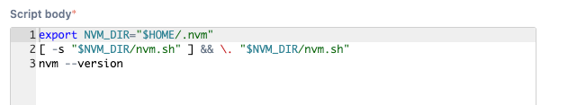

2. Or add it in the script task ( like attached )
When you run this script task, you should be able to see the results.
