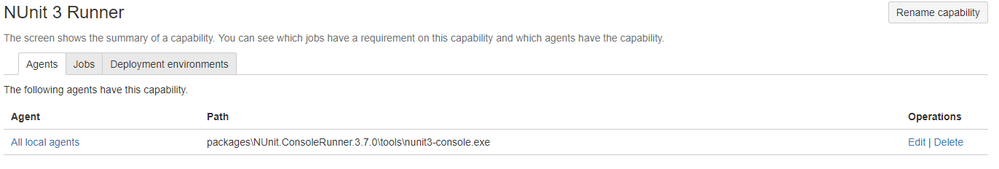

The console runner executable is located in the packages folder of my .NET project and if I dive into the checkout directory on the build server the .exe is in packages\NUnit.ConsoleRunner.3.7.0\tools\nunit3-console.exe which is where I have Bamboo looking for the executable:

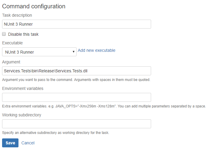

And in the build plan I have the following in the Command task:

Usually, for Command type tasks, I use absolute paths. I have the Nunit executable in a specific folder in my build agent and point to it. Would you try this approach?
If your file must reside in the source code repository, I would try a Script type task. In Script tasks you can for sure use relative paths.
