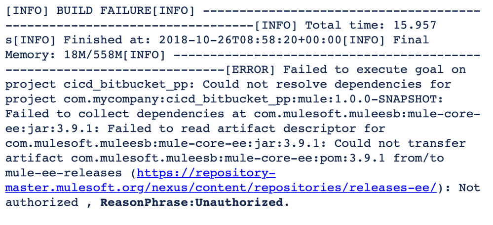

bhagyashree khedkar
October 28, 2018
Below is the error,
Its mule application and I want to setup CICD using bitbucket pipeline.Screenshot 2018-10-29 at 14.30.49.png
Rohit
October 29, 2018
we have been using Bamboo for CI/CD and what you are using is quite different Bitbucket Pipepline for CI/CD.
But the issue looks same, the project couldn't fetch the dependencies required for Maven build. You need to update settings.xml file with nexus repository credentials.
As you set up Maven on your local machine do the same on the bitbucket server pipeline also.
check if this helps
https://community.atlassian.com/t5/Bitbucket-questions/settings-xml-configuration-on-Pipelines/qaq-p/167693
