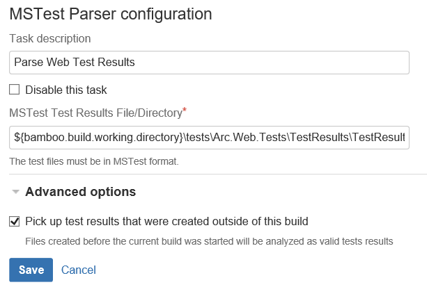

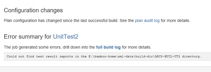

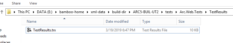

I set up an MSTest Parser Configuration in Bamboo like this: ${bamboo.build.working.directory}\tests\TestResults.trx. When running Bamboo doesn't resolve this. It only replaces $${bamboo.build.working.directory}, but does not append \tests\TestResults.trx and therefore cannot find the .trx file. Note: the .trx file is being created properly.
What am I doing wrong?

Most of the tasks in Bamboo have the <bamboo_build_working_directory> path as their default path to work with data. It means that if you don't provide any path, the one used it the working directory. It also means that you can use relative paths.
The value to MSTest Test Results File/Directory field on MSTest Parser task can be either:
  • tests
  • tests\TestResults.trx
  • ${bamboo.build.working.directory}\tests
  • ${bamboo.build.working.directory}\tests\TestResults.trx
⚠️ In the options where the file TestResults.trx is not there, the task will search for any file with trx extension.

Please try:
  1. Use the relative path  tests\TestResults.trx or tests.
  2. Check the option Pick up test results that were created outside of this build in the advanced section.
  3. Run another test and let us know the results you get.
  4. Please share the full error you see in the build logs.

The file exists. Bamboo doesn't find it because Bamboo isn't resolving the directory.

tests\Arc.We.Tests\TestResults
I just want you to run this test with NO working directory variable and the file name which are not needed in this case.
Ariel R. Conti
March 20, 2019
That worked. Thanks!
