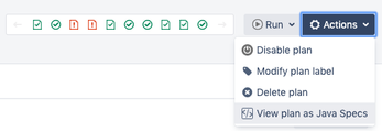

In case you are not familiar with JAVA specs, the main configuration is already available for you through  Actions >> View plan as Java Specs :
