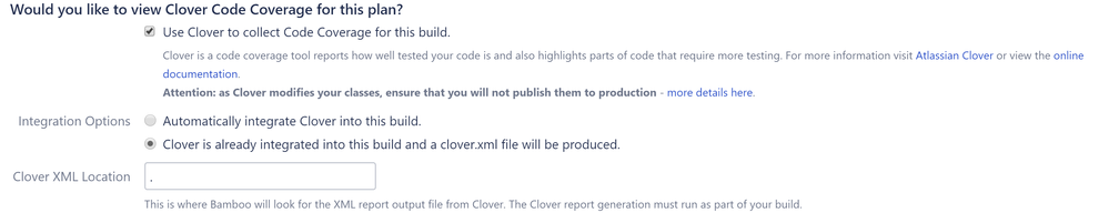

Here is my configuration

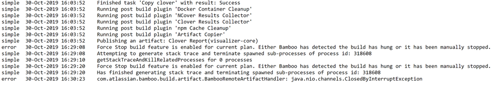

The output I get is shown below, everything looks fine.

I can see the problem is happening when publishing the artifact. I'm not really sure if the clover plugin is the only source for this issue. I have some questions that would help us to investigate this scenario further:
