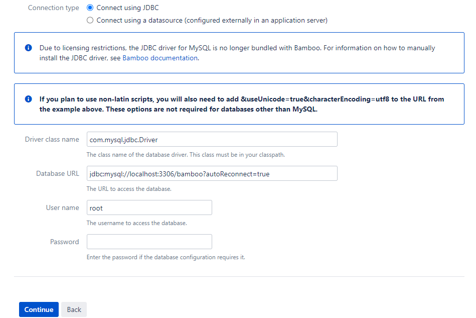

I am trying to install  Bamboo 8.1.1 in my local Windows Machine. But getting issue during installation. Please find the attachment which I got issue.
During installation I have installed mysql database workbench  in my local and setup user id and password. Apart from this setup mysql-connector java in "C:\Program Files\Bamboo\atlassian-bamboo\WEB-INF\classes" folder.
While I click on continue, Its redirected to same page, its unable to jump to next step. Please check and help me on this.

the mysql-connector jar must be located in <Bamboo installation directory>/lib
Please see also https://confluence.atlassian.com/bamboo/mysql-289276817.html

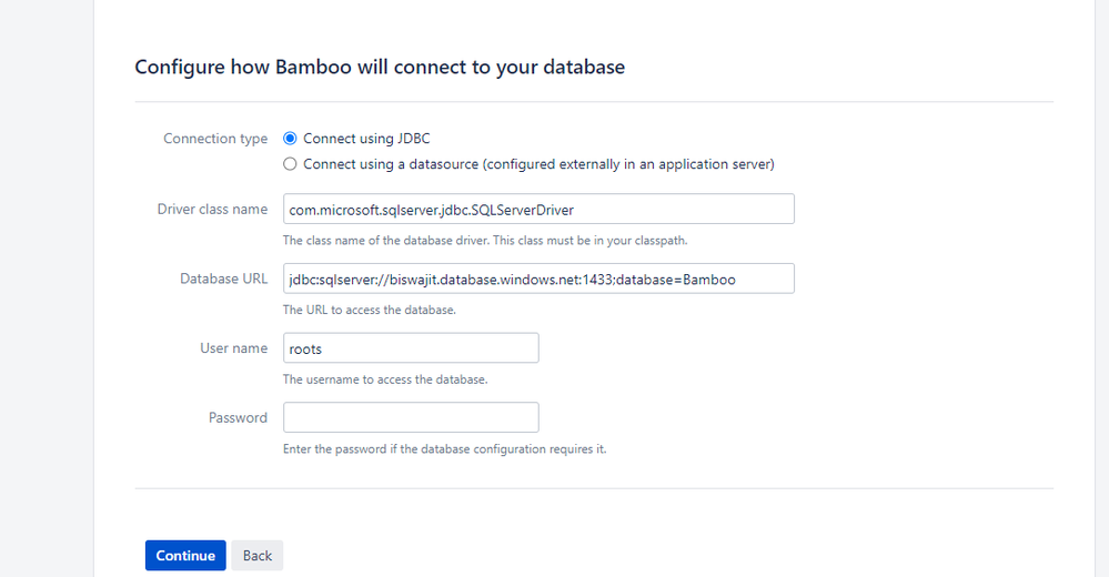

According to your link, I tried but got Capture1.PNG "Please wait while we setup your instance"
Then I remove my sql server and create MS Azure SQL server, Please check my attached screenshots. But Still its stuck in that same "Please wait while we setup your instance"
