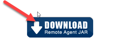

When you click this to download the jar file and I move it to the server. When I double click on it. there is no install action. I also try to unwrap it and it fails..

@Michael Castro
Please check at the page where you download the agent
there is the command stated that you need to run
see also
https://confluence.atlassian.com/bamboo/bamboo-remote-agent-installation-guide-289276832.html
