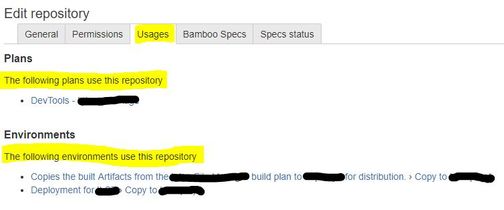

So you have two options here:
1) You can create a new linked repository that uses a different name but links to the same repo and uses a different default branch (I have done this myself for the exact reason you have listed above)
2) You can check the "Usages" Tab on the linked repository to see all the Build Plans and Deployment Environments that reference/make use of that linked repository:
I hope that gets you what you are looking for.

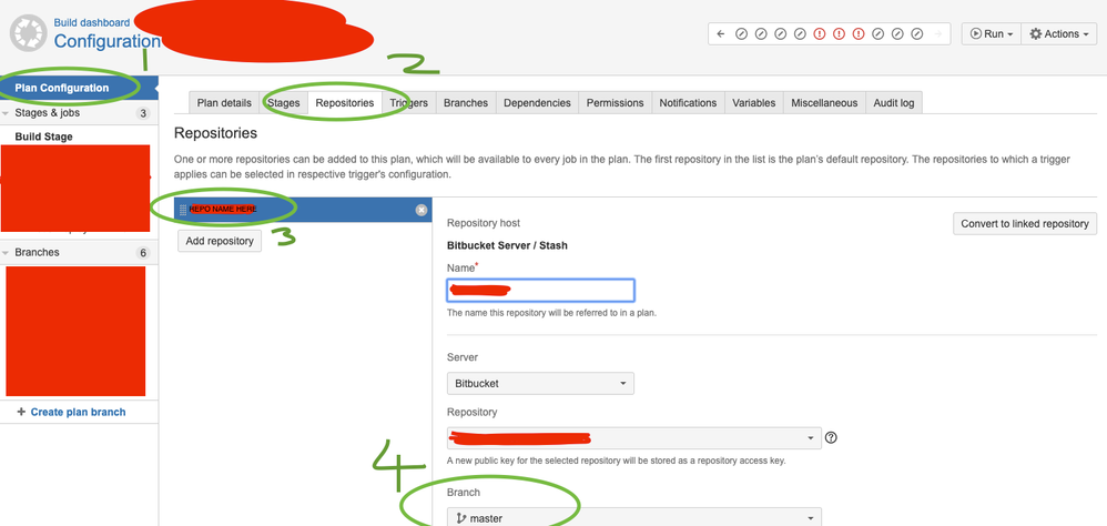

Adam Sir
May 23, 2019
** SOLUTION **
Hi James wow sorry i thought I replied to this with my solution. So I was actually able to solve this by doing the following if you refer to the screen shot below. It's been working fine since the noticeable differents are the feature branches have changed naming convention in Bamboo.
They now have feature/2.0 <-- with the`/` character rather than the `-` character. Also I have encountered different issues running it with this "default branch" that is triggering other branches but I believe that is project specific - still investigating however not affecting my desired result.
I really appreciate your help James! Thank you kind sir!
